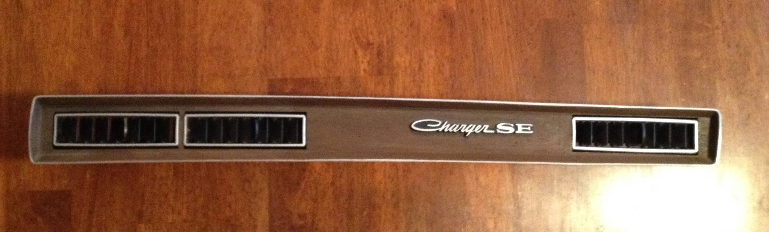

Mar 8, 2022 #4 EV2RTSE Well-Known Member Joined Dec 13, 2013 Messages 245 Reaction score 139 The vents themselves or "spot coolers" as I believe they're called, are interchangeable with those from a '71-'74 B-Body. Also here's a link on how to repair them. Charger Center A/C Dash Vent Resto How-To Charger Center A/C Dash Vent Resto How-To www.dodgecharger.com Attachments IMG_1463.JPG 201.7 KB · Views: 98
