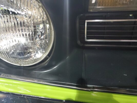

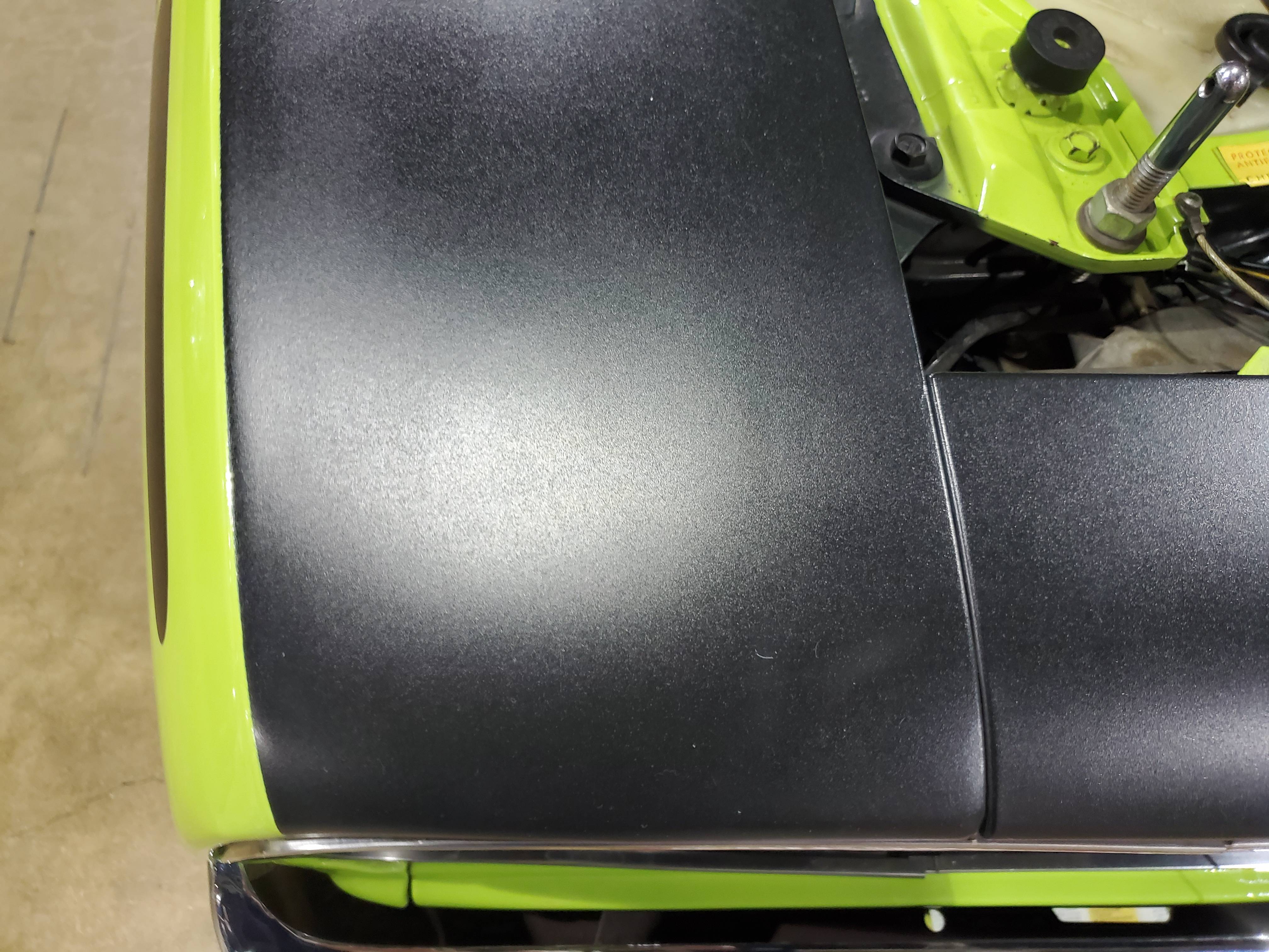

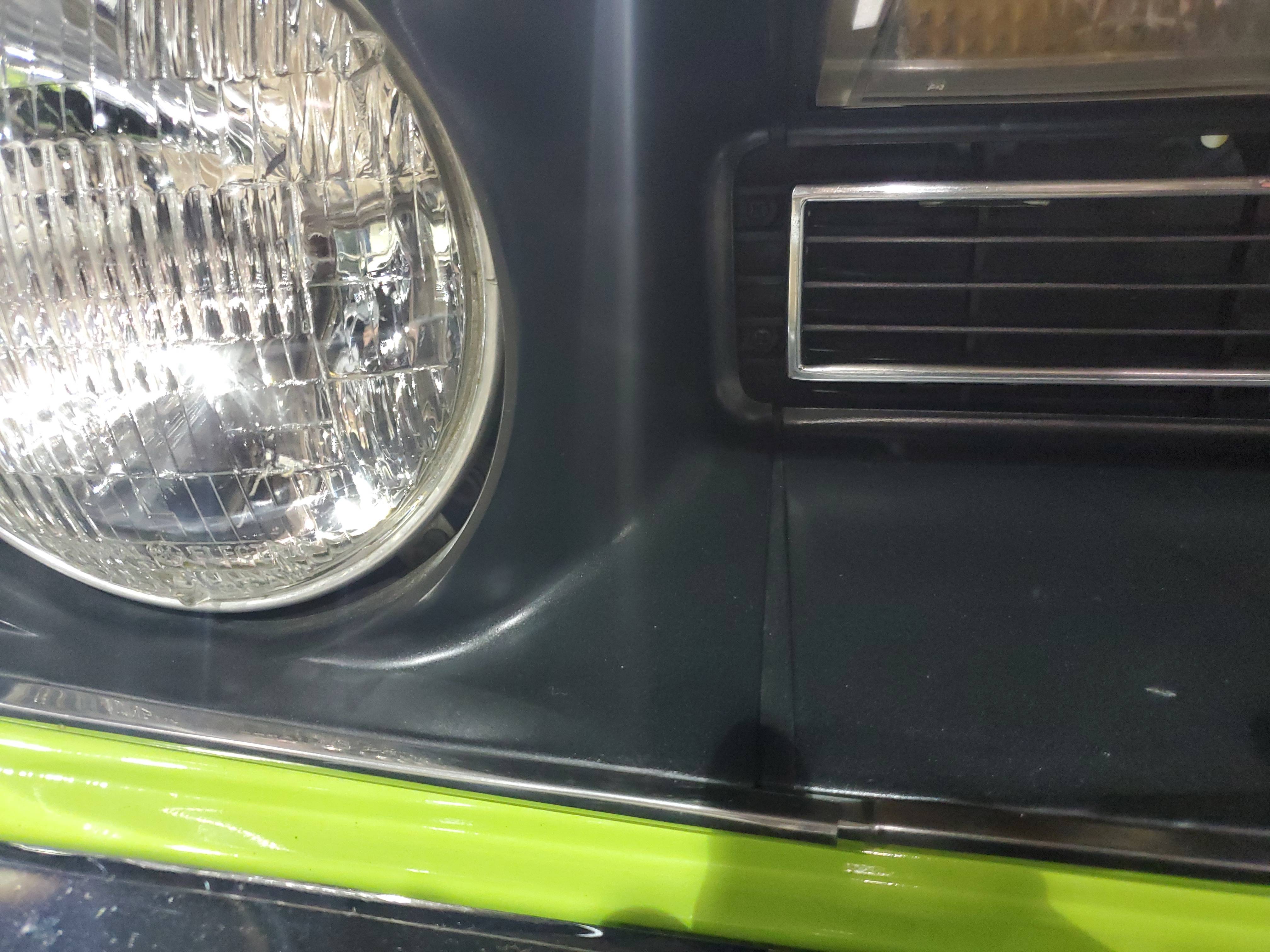

I am in the same position. Mike Ross was gracious enough to sell me one of his few remaining grills. At MCACN, I shot these of Wellborns survivor. It almost looked like organisol, with a tiny, and I mean almost NOT there amount of silver flake. The finish was glossier than say the organisol on the hood. I don't mean glossy. It had a more subtle texture to it. 50 years later, I think paint certainly lays down. I am still up in the air on what to do. I want to see more this year before I tackle it. Don't know if this helps. Here's the pics.
