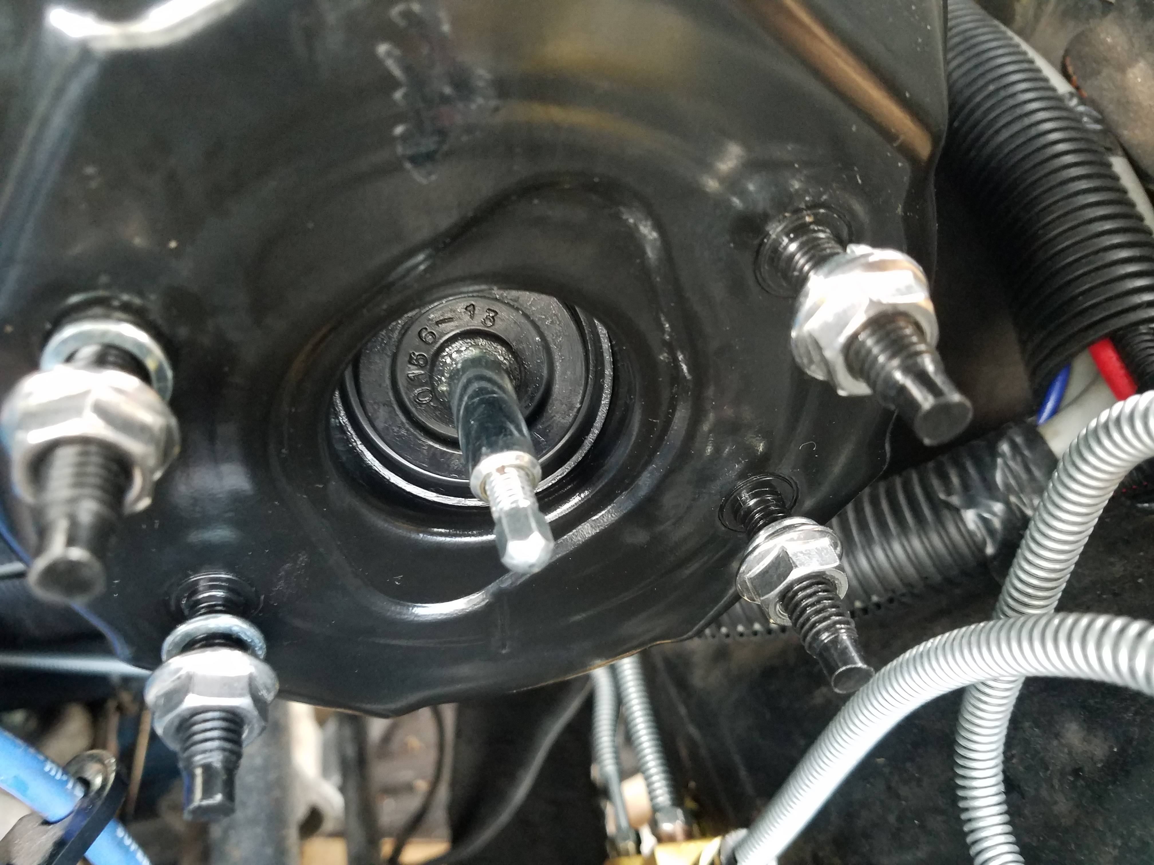

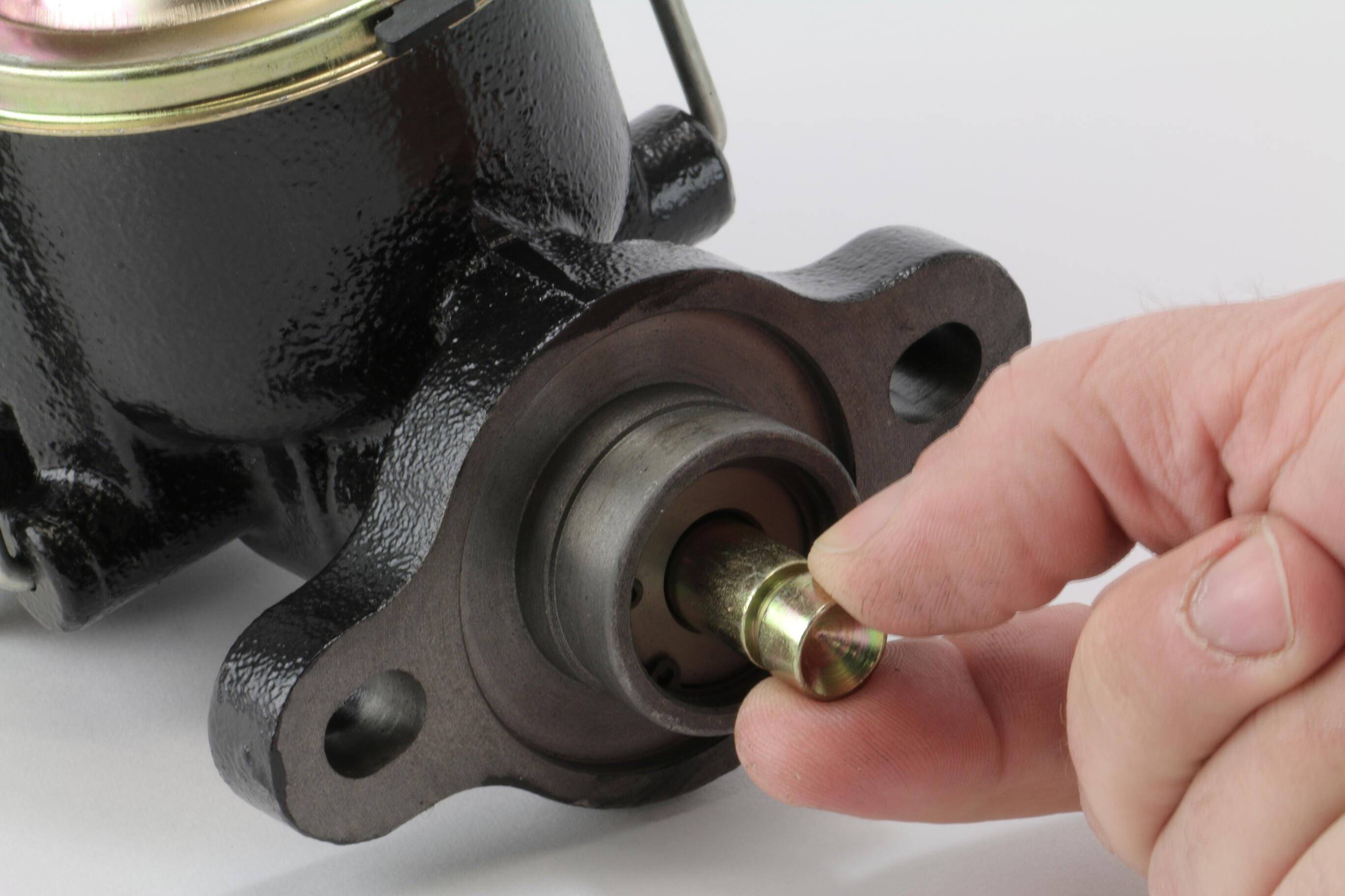

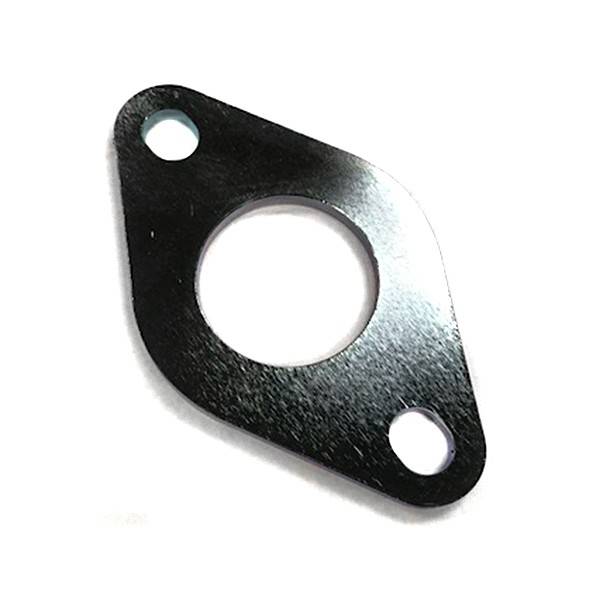

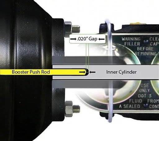

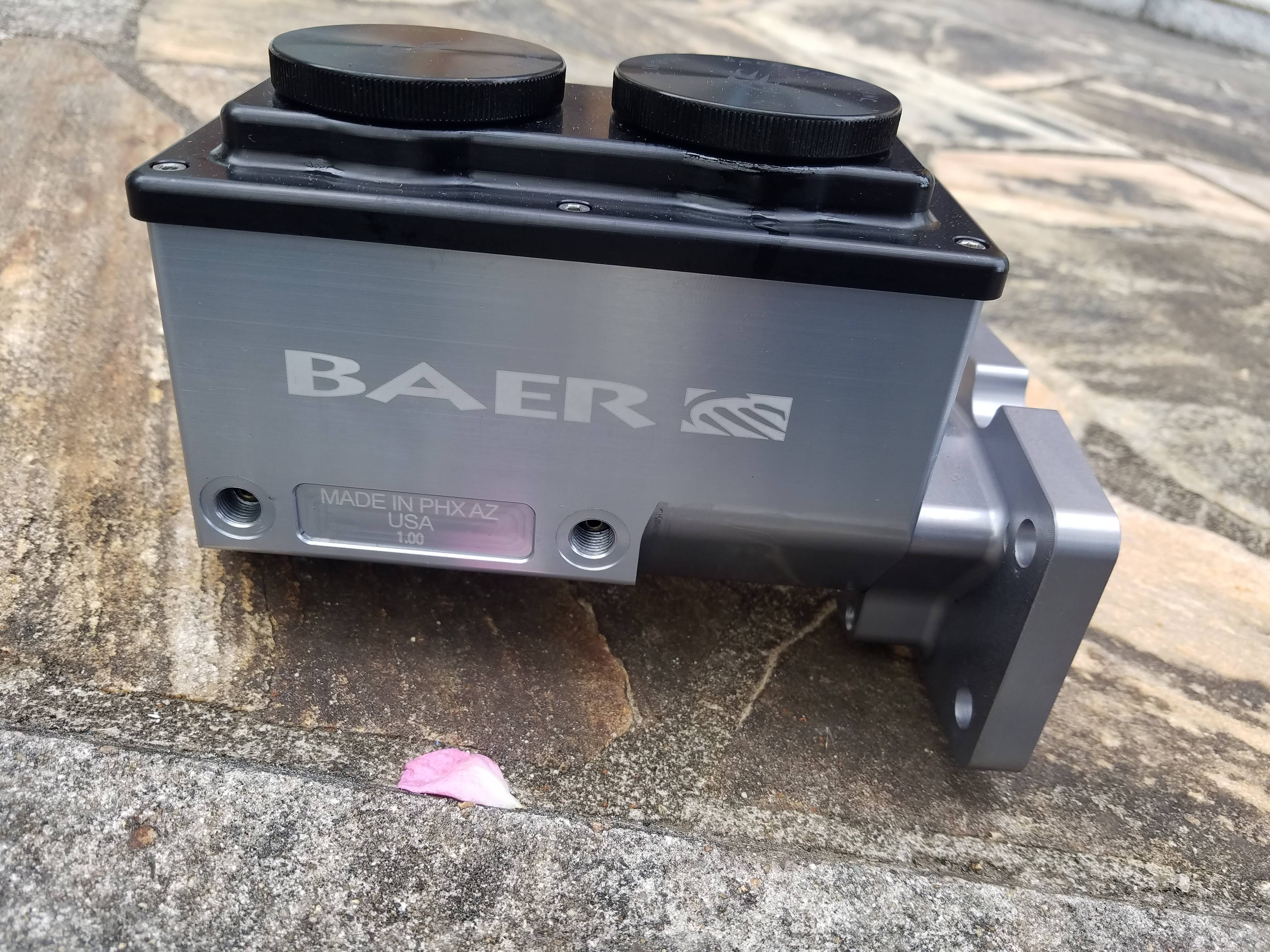

Hello! I replaced the brake booster and master cylinder to change the brake system. I tried to install it, but there is a gap of 1 inch or more between the brake booster and the master cylinder. It is not enough (approximately 0.2 inches) to fully adjust the rod of the brake booster. There was an image of attaching a spacer to the master cylinder, but I could not find the product. If you understand, please tell me how to do it. Also, although it is a gap, is 0.20 inch correct as shown in this image? The brake booster is 760171 of the summit, and the master cylinder is baer6801300LP.
