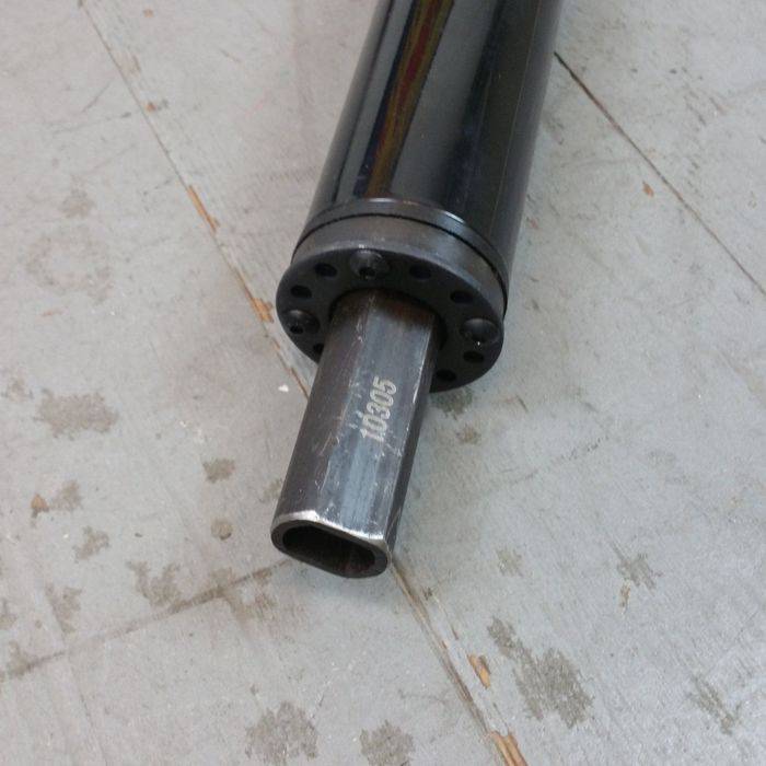

I am looking at buying this aftermarket column since mine is destroyed. Can anyone tell me what i need to adapt this column end to my stock 1970 challenger steering box?

I figured out i need a u joint and a 1" dd steering shaft. Are these in any 90s-2000s cars/trucks i could find in a junk yard?

thanks for the advice but i figured out what i needed and bought it because it was on sale for cheaper than any stock columns plus i can tilt it which will be useful since i'm tall. its a floor shifted auto. do you know what the size the shaft on the power steering box is? i cant find it online and i'm at college away from my car.
