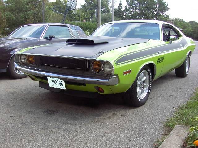

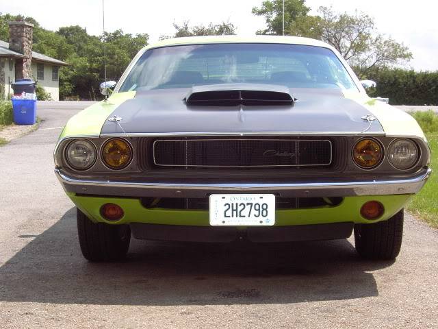

I've had a few members ask me about my amber high beams so I thought I start a post on what I did. They are not every body's cup of tea but I like the look. I had them on my first Challenger in the 80's I guess it's sort of a nostalgic sort of thing to me? ( don't mind the " mullet") LOL
They are fog lamps from here.

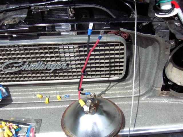

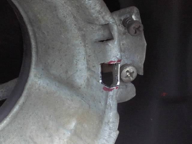

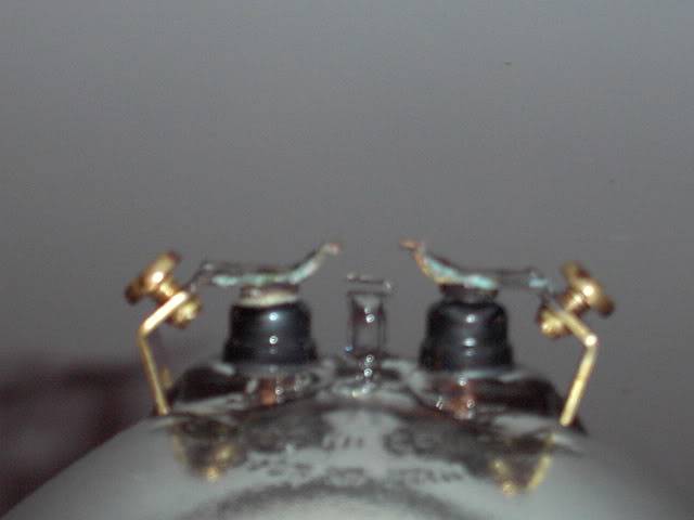

You will have to slightly notch the bucket as the bulbs have differnt clocking for the locating lugs. The bulbs also have screw on terminals so I made a easy and cheap "harness"
