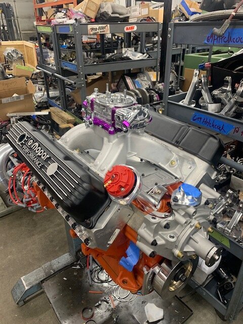

How did your install go? I had to deal with the same issue. We built a 400 Lowdeck 512 stroker. Ended up going with the trick flow intake. The heads are trick flow 240's going in my 1973 Dodge Challenger. Haven't install the motor yet. I'm worried it want clear. It looks really tall in the stand!!!

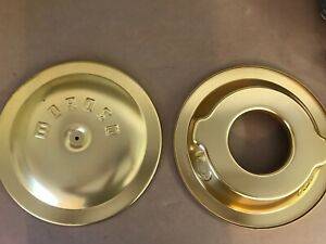

I am running EZ heads on a RB 500CID using an Edelbrock RPM dual-plane. To get the Shaker scoop to sit correctly, I modified a repro shaker base (fiberglass) to drop the shaker about 1.3". I used an aluminum (gold-anodized Moroso drop-base painted satin black) which was bonded to the fiberglass shaker base after cutting out the fiberglass center. the Moroso top was not used. I then used a K&N 14" x 1-1/2" filter with a matching K&N Xtreme filter lid. Not ideal for air flow but it at least got the shaker scoop to shake and sit properly.
