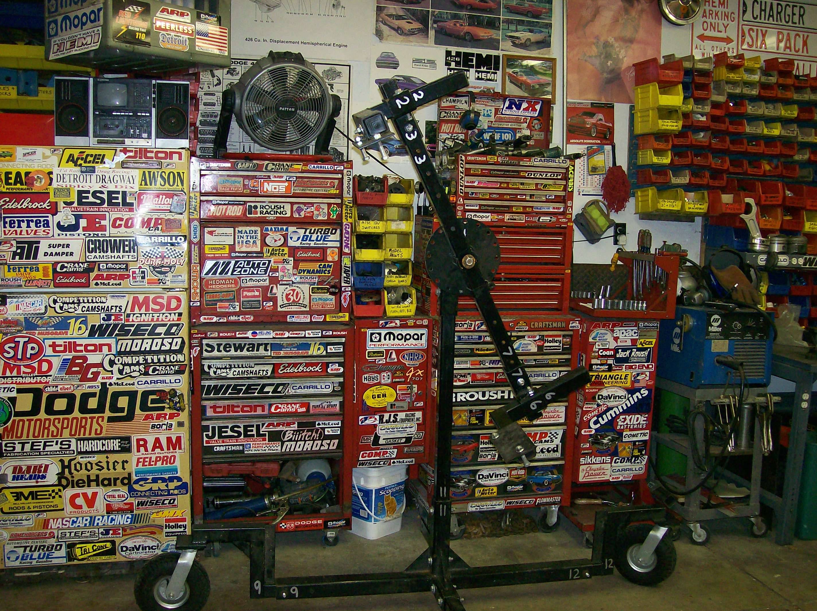

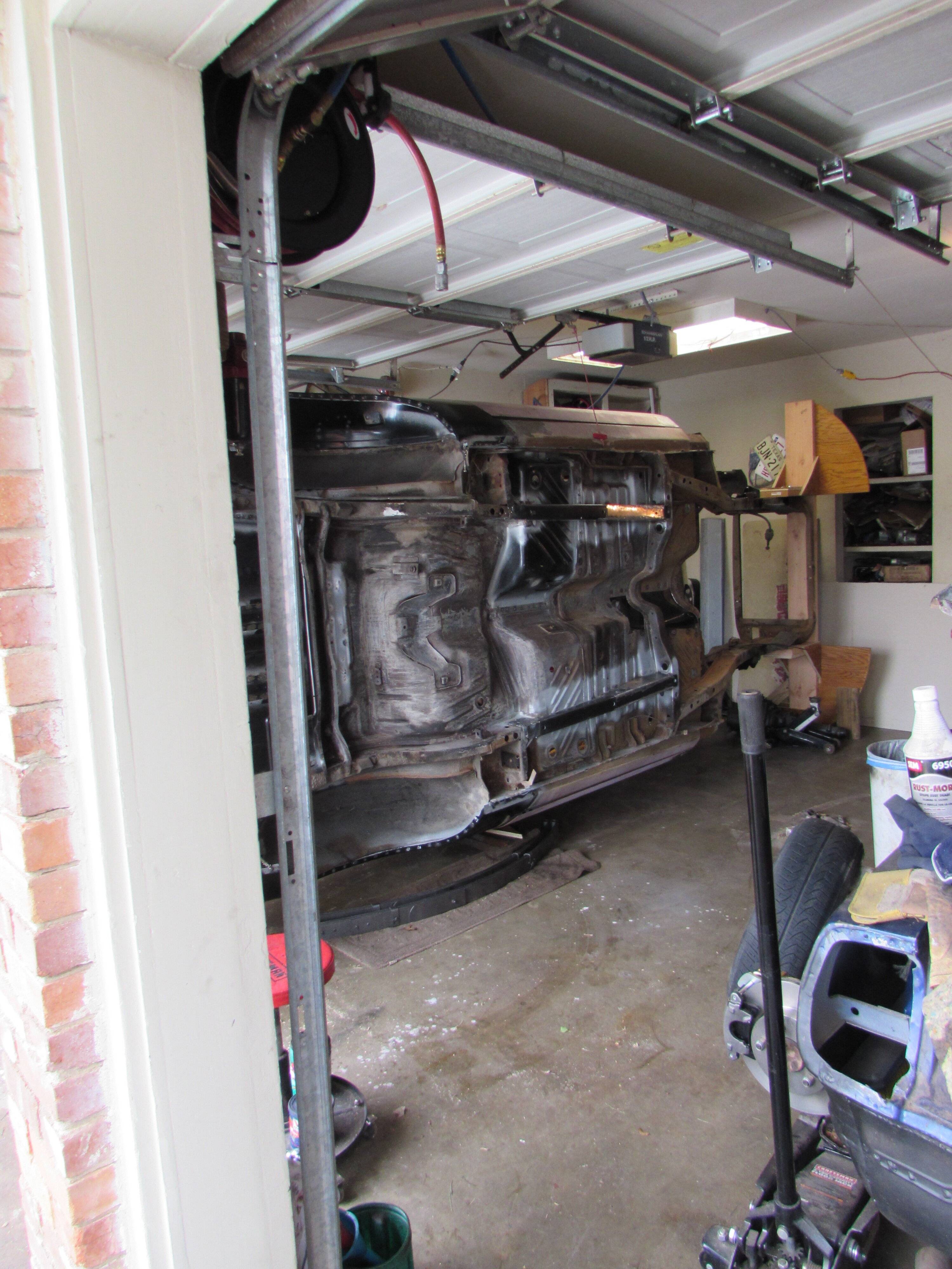

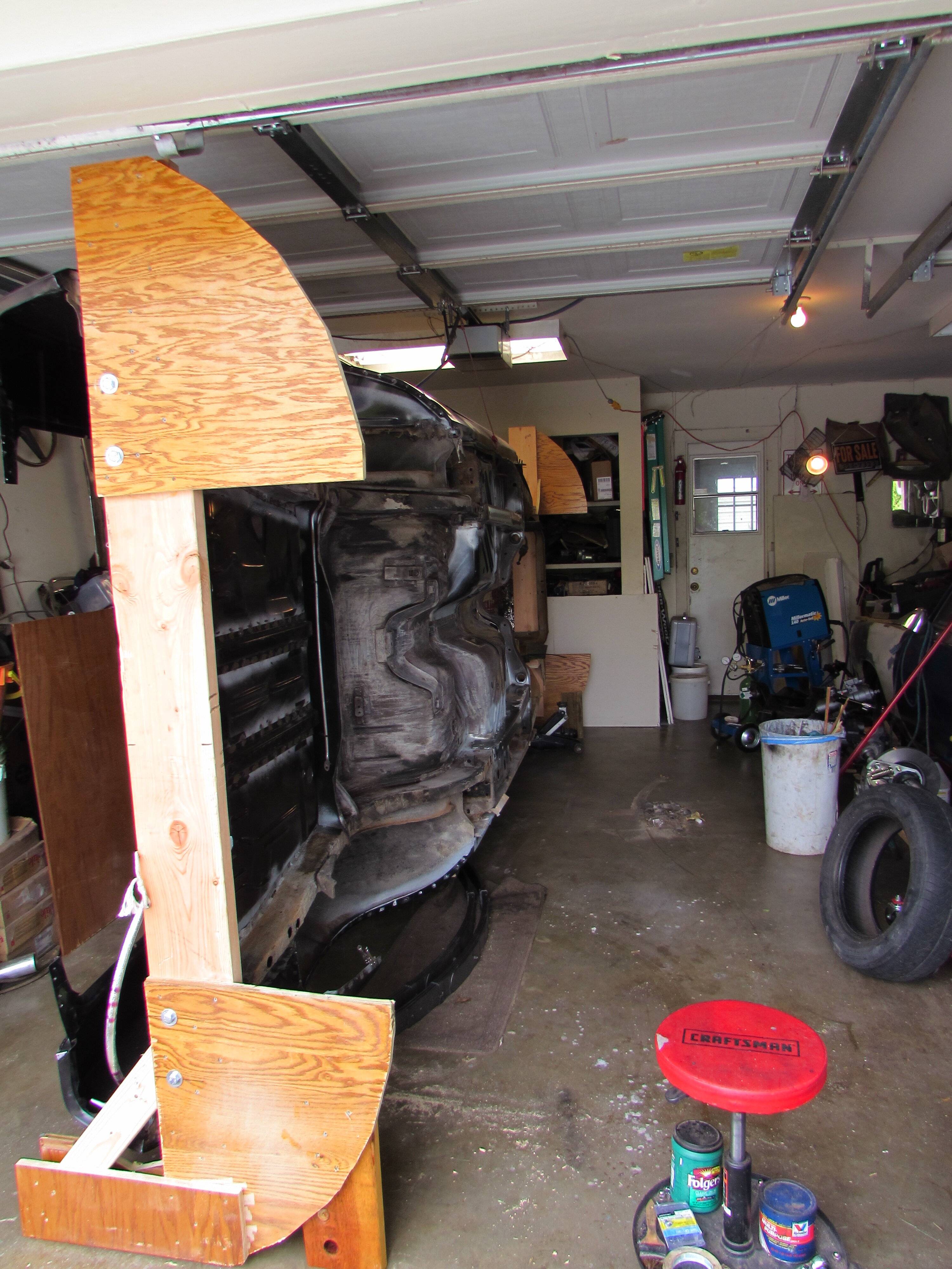

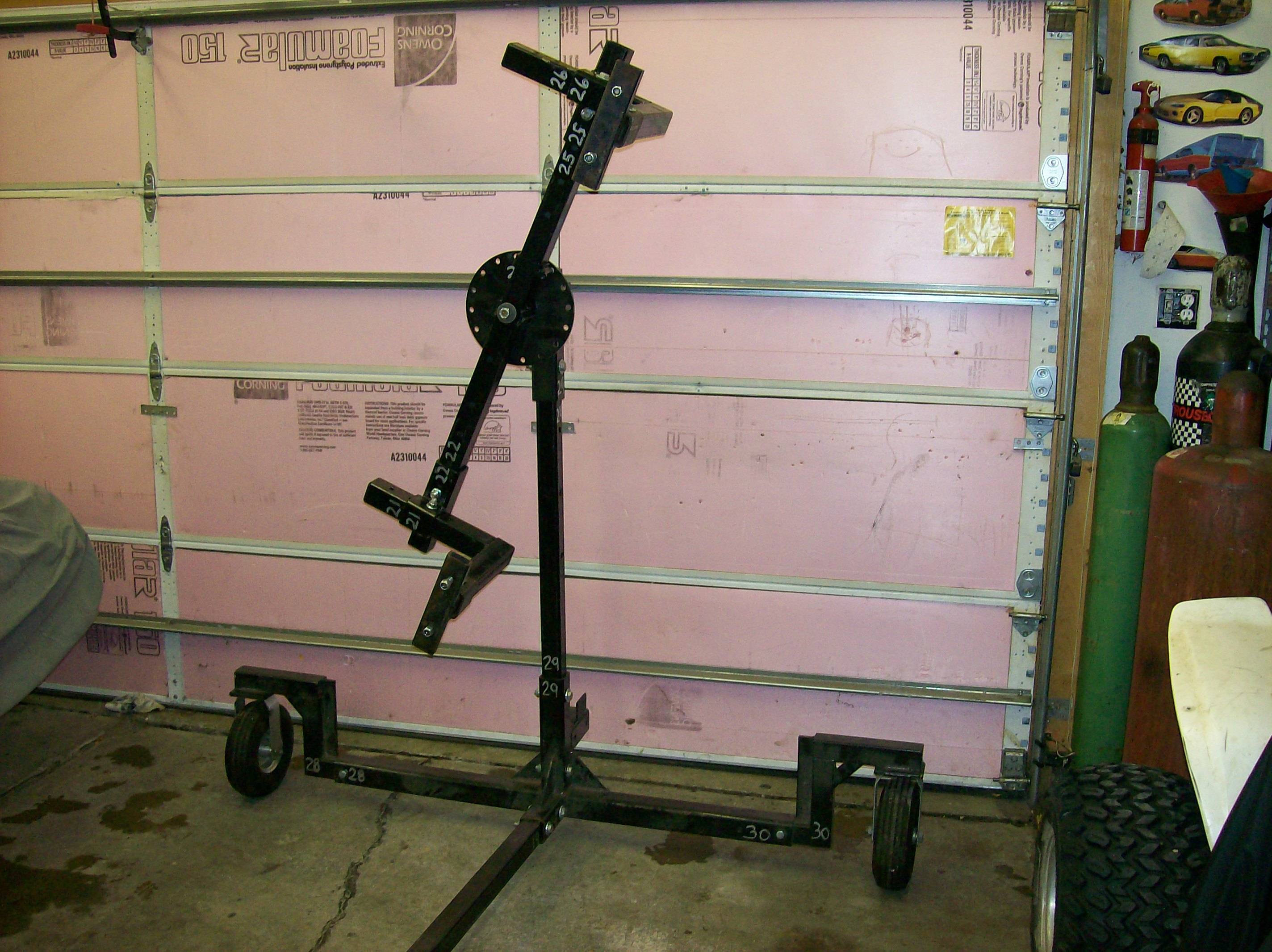

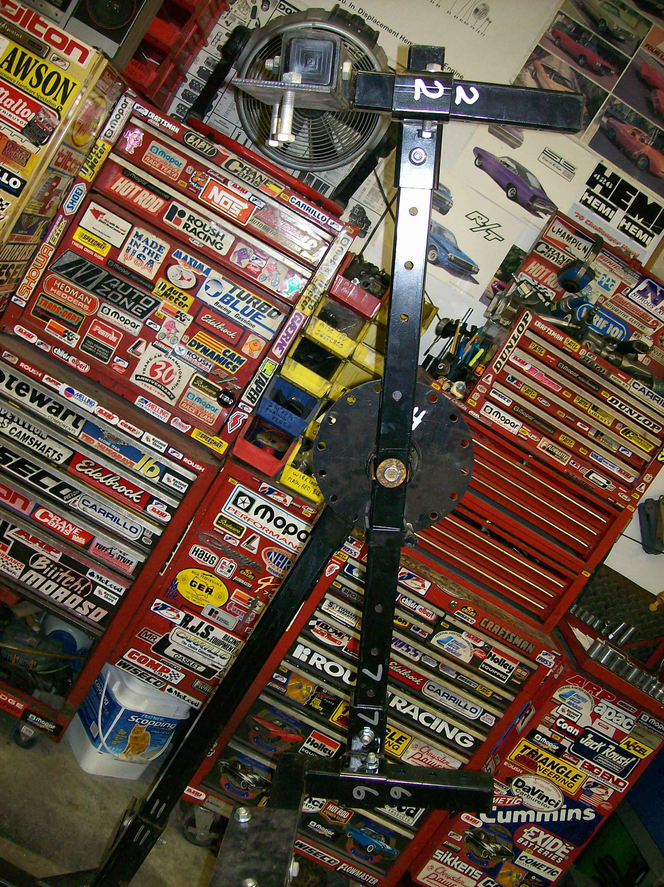

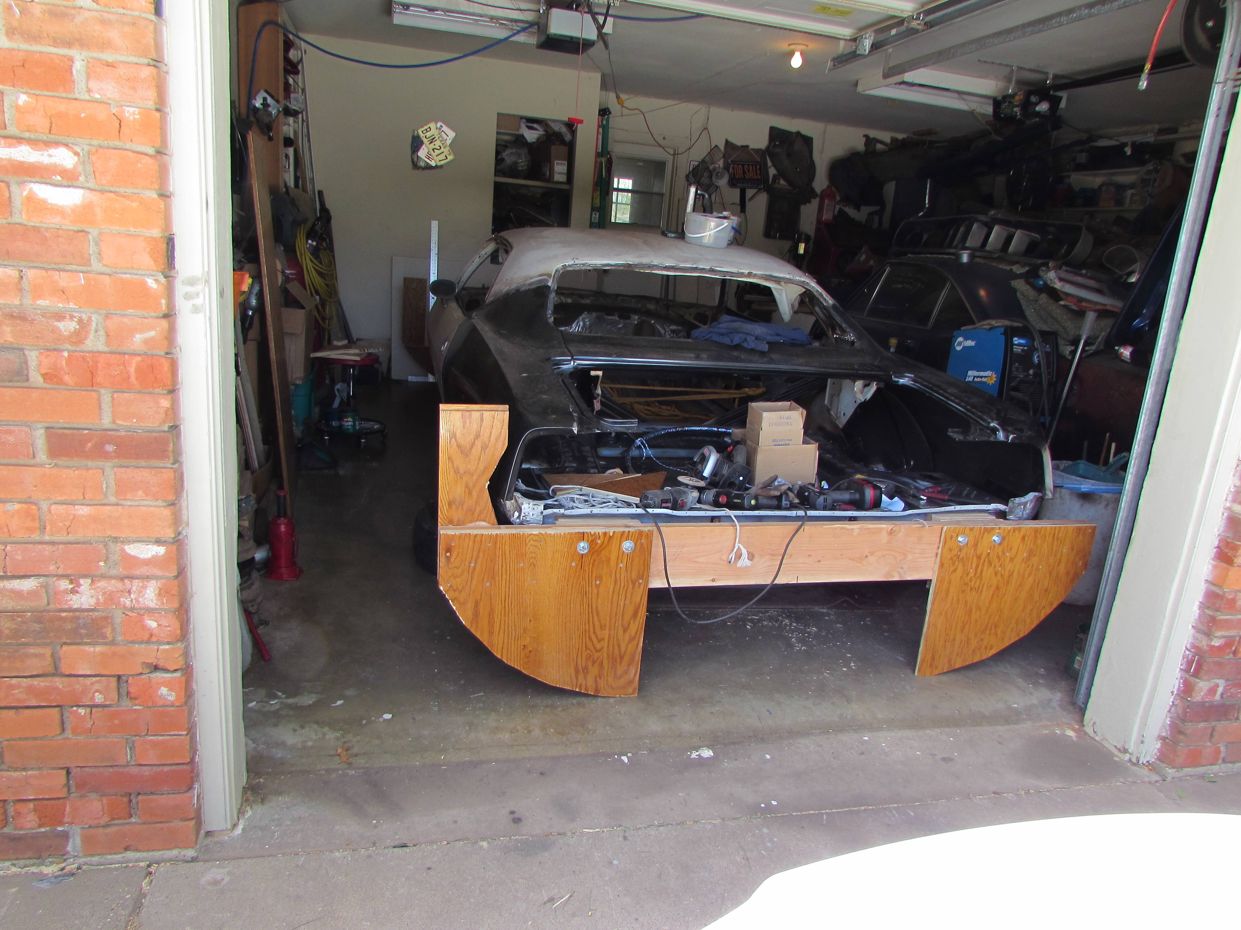

I think you are over thinking it, once you have the body connections made/attached (mount the fronts to where the bumpers attach outboard of the frame and mount the rears where the rear bumper brackets attach), connect them to the rotisserie and then its just adjusting the ends up/down until you get it balanced. Its really not that difficult, I've done it a number of times by myself without issue.
