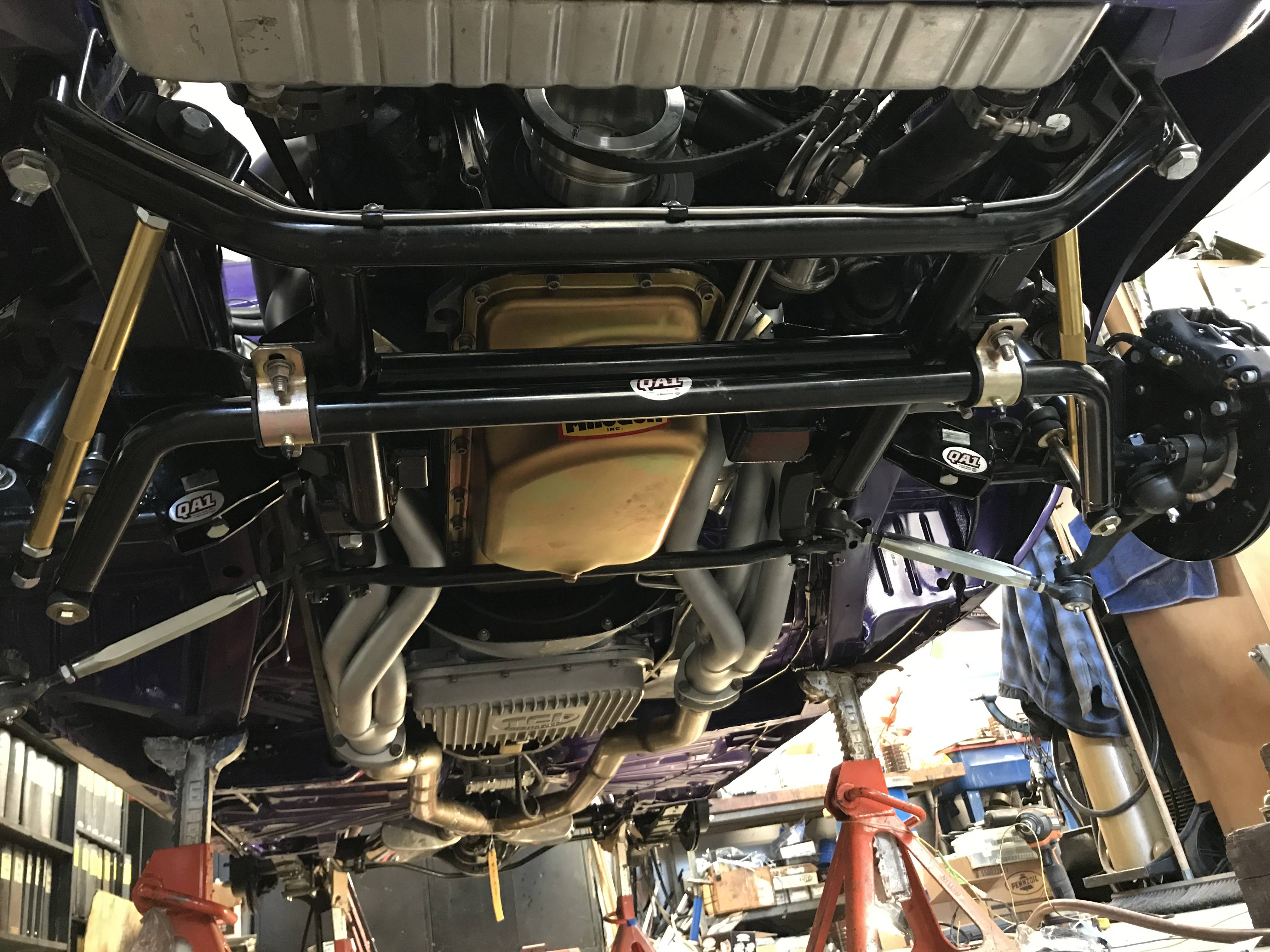

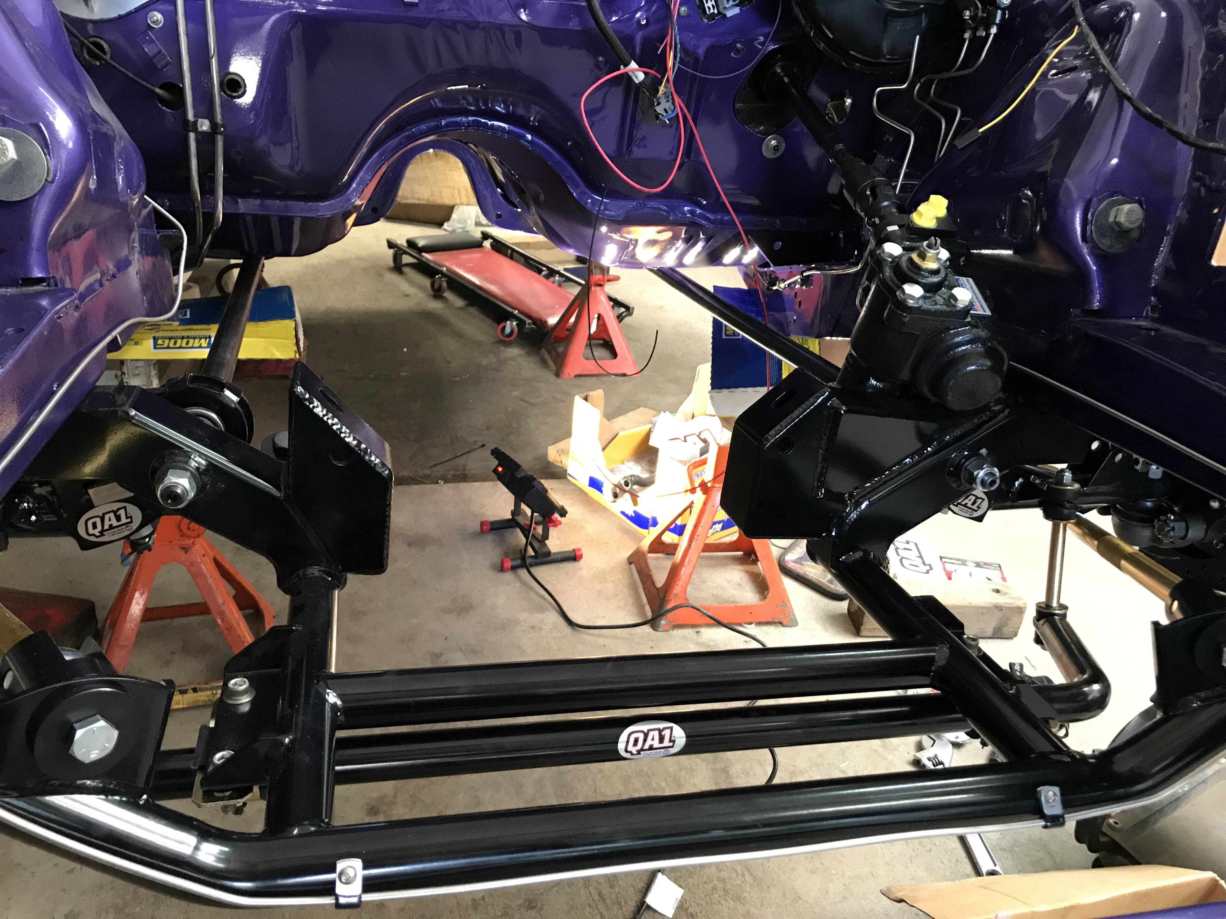

I did the complete package on my ‘70 Cuda, everything bolted up perfectly. All the components are well built and I no reason to believe they aren‘t as strong or stronger than the factory K member and suspension pieces. We’re gonna fire it up and get it on the road this spring. Best of luck with your project, sent some photos, Happy Hot Rodding!!

The QA1 frame is only something like 4 or 5 pounds less, so maybe not the best investment for weight savings. That said, I have one going into my car for the extra room, and stiffness. Plus, my original had suffered some hacking somewhere in its pryor life.

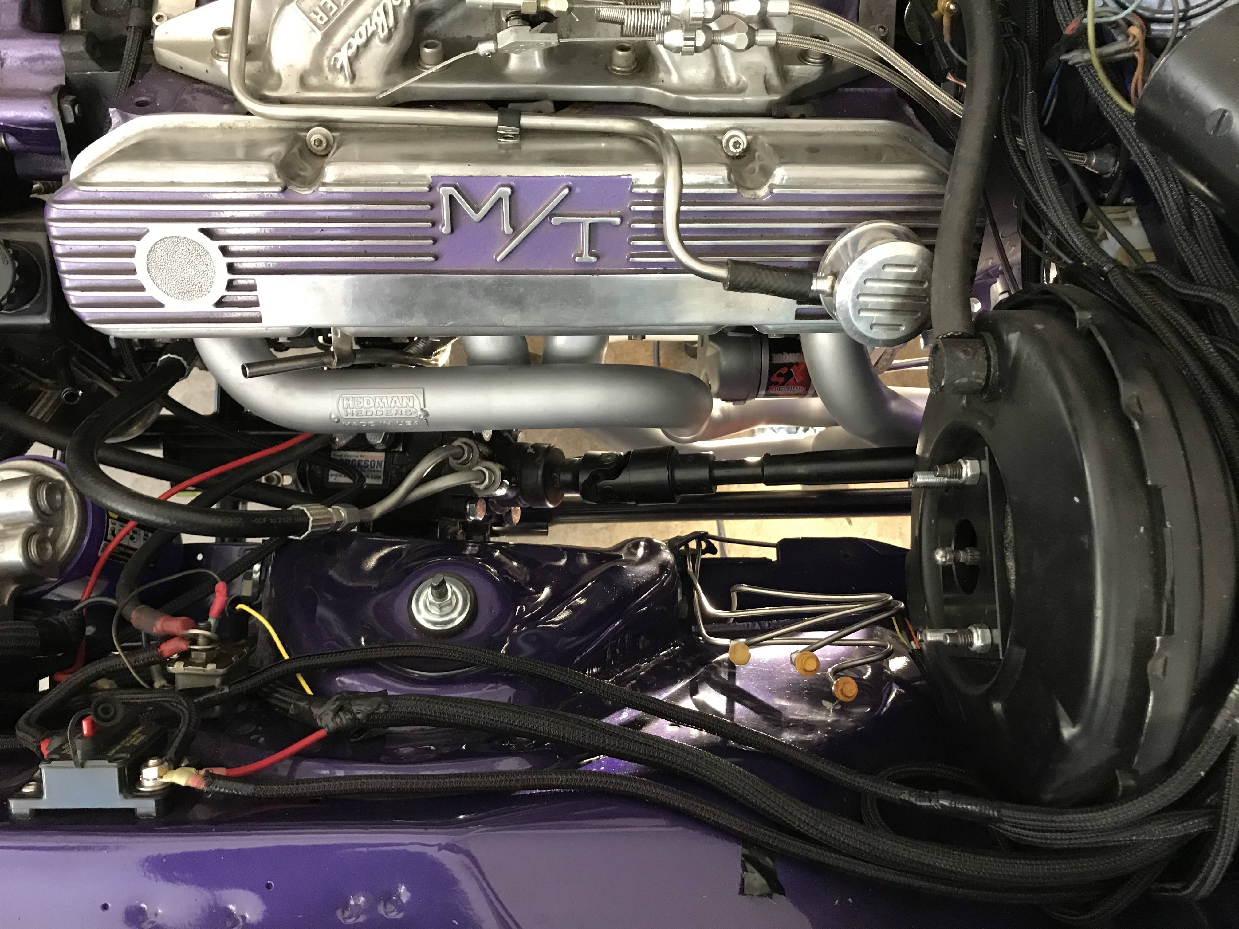

GREAT look!!! Very nicely implemented as well. One question. The steering box??? Pretty sure a stock steering box will bolt up, but yours looks smaller than mine. I will email Mancinni and insure all the details are in order.

You’re right, it’s a Borgeson unit. I want to take advantage of the new suspension, and quicker ratio box will compliment the setup. Also, header clearance, now I don’t have to use a heat shield on the box. The stock box will bolt right in, depending on your exhaust system, clearance can be an issue. And many thanks for the compliments. And again, best of luck with your project, post some photos when you have a chance.
