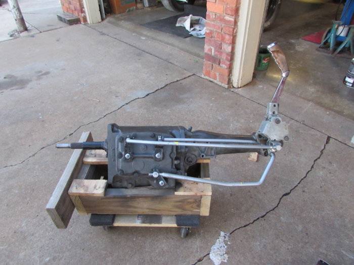

What needs to be changed on a b body 4 speed transmission to fit in an e body car?
The ratios are a bit different and that's all I can remember.

Shifter on an E-body is mounted on the rear. Reference pic of my e-boyd transmission with shifter prior to installation. You will need to drill and tap the holes for mounting the shifter. Make sure you have the right bellhousing, good to go.
