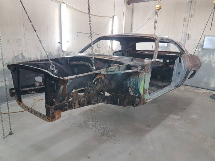

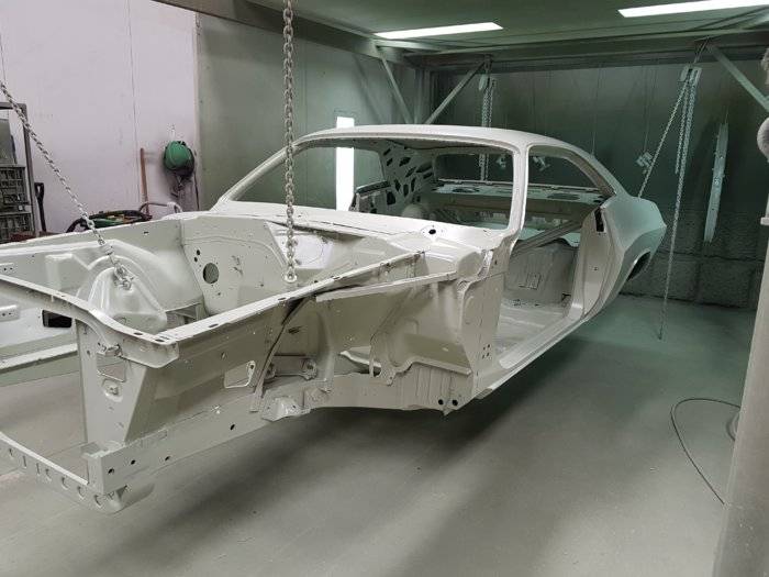

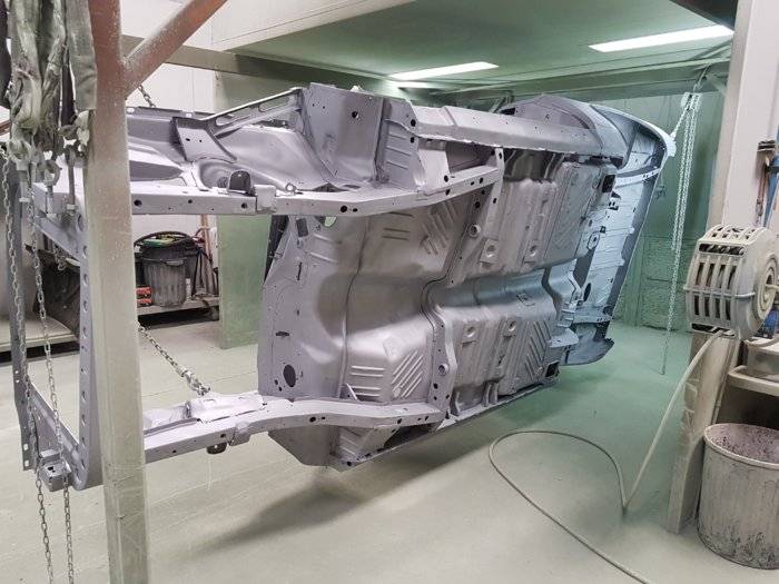

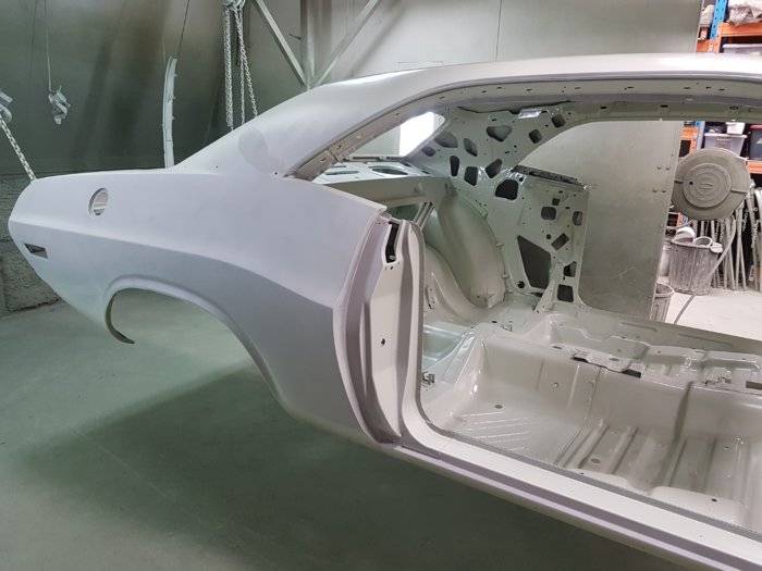

    Decided on sandblasting & primer this time operator uses a superfine media changed the rusted trunk floor ,cowl & lower rear quarters prior to blasting.
    Mark heres another of him doing the underneath & other side.

    Night and day!:thumbsup:

    Looks great AUSTA:thumbsup:. What's the plan for this Challenger?

    Not sure what it was originally had no fender tag or build sheet all we need in Australia for licensing is the body VIN & Dash Vin.
    It had a non matching slant 6/904 the VIN is for a /6 car
    2 pistons had melted holes you could drop a golf ball through & 3 badly burnt valves still running only just
    Originally a B5 blue/Vinyl roof with a lot of options weather they were added or factory who knows
    May have been WWS had all the chrome trim & rocker panel covers
    Getting a R3 426 /727 8 3/4 3.55 Torsen ,Gator grain roof not sure on the Decals TA / RT ??
    Was Blue interior with a chromed dash
    Owner has put all the best parts on the car rubbed it back then left it in the weather for a couple of years it was last licensed in 2017
    I think it was used as a shooting jalopy the car was full of bullet shells with a couple of bullet holes in the floor found a couple of unopened cigars in the Aluminium casing down in the back cavities looks like it had an interesting life
