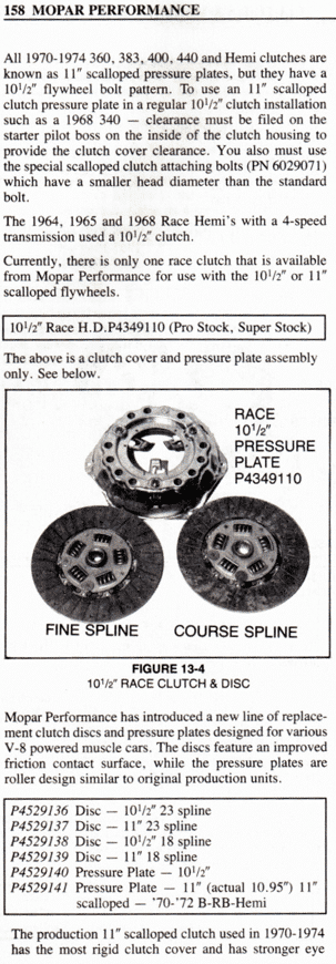

Here is the scoop , the 143 tooth flywheel & the 130 tooth flywheel both use the same 11" disc , the 130 tooth is called a 10.95" to differentiate , Never waste you time with a 10.5" disc , it works for 318s maybe , , you need 11" [10.95 "], there is no advantage to swapping the belhousing & flywheel to the 143 tooth .

The real 11" disc would catch on the 11" scalloped PPs. The reason for the "10.95" disc was to use a larger disc with the normally 10-1/2" 130 tooth flywheel.

If you say so , I order the exact same disc from McLeod for both so they are probably only making 1 disc as the same part # came up for the disc in both applications , it may be 1/8" smaller .

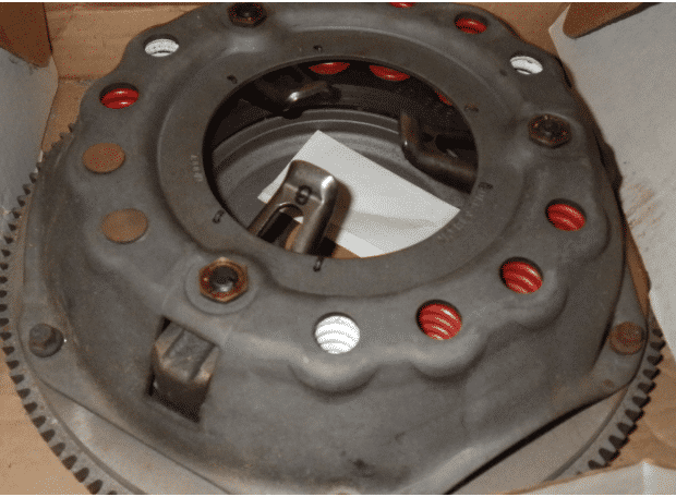

@Chryco Psycho
The best clutches I have found are McLeod street twins using dual discs , worst I have found are Centerforce , they will hang on high RPM shifts & I have seen them last less than a weekend !
I prefer 3 finger type , this is what the car was designed to use , McLeod used to make a B&B Long with lighter pedal pressure in a street twin which is what I am running .
Is this the pressure plate you refer too? Its the only Mopar B&B style I can find from Mcleod. Not cheap!
Chryco Psycho
4,438
2,080
Panama
Yes that is the pressure plate I have most often used in the past .
As I have learned , performance is not cheap , you can buy 5 $200 clutches & keep replacing them or buy 1 good one that will last , a lot less labor buying good parts the first time !
With a well built 500+ CI stroker you can make a lot of torque most single disc 11" clutches will not hold it for long .
