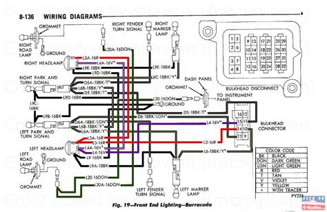

OK Did some more probing. First I should say that I recently changed the front end lighting harness and also installed 4 new OEM side marker light housings with the attached pigtails. I was thinking a headlamp switch or the dash dimmer switch which are both original to the car and maybe why my running parking lights are not working. So I installed two new switches and I also removed the cigar lighter . I am now not blowing fuses but I still do noy have dash lights, side marker lights or parking lights. I do have headlights high and low. Brake lights and directionals and 4 way flashers all work? So now I am wondering about the brand new OEM side marker lights up front of maybe the new front lighting harness. Any thoughts?
The ground is in front of the battery. Unplug the bulkhead connector. Check to see if you have power at 11 Black Tan tracer and 10 Black yellow tracer. You can power up the light from the front harness. Use a fused jumper ( not really needed you will know if there is a problem.) and connect to 10 and 11 see if they power up. If you blow a fuse with the front light harness unplugged the the problem is under the dash. It would be a good idea to unplug the rear harness behind the kick panel. It will help narrow down the problem.

I spent 5 hours today isolating the front lighting harness which was just bought from year one. I ended up just disconnecting (unplugging) the two front side marker lights and the two front valance parking lights. I then sent power down number 11 and did not blow a fuse. I then attached just one side marker light and sent power down 11 again and blew a fuse. The two front marker lights were just bought and are the OER units. I then took one of my old front markers and plugged it in wfter removing the new OER. Guess what? My old marker lit right up and fuse did not blow. So then I hooked the parking light on that same side and powered it up again with no blown fuse again. So I went to the other side marker light which was brand new from OEM. I plugged it in and powered it up and guess what? Blew another fuse.... I then took my old front marker and swapped it out for the new OEM and powered it up. It lit up and no blown fuse. So I then plugged the other front valance parking light in and powered it up and now all the side markers, my tail lights and my front running lights all work.... I guess what I am finding is that the two brand new OER side marker lights have to be defective and causing shorts which was blowing fuses. I am pissed. Took me 5 hours on my back checking and testing. Friggen Chinese junk is what it is. And I paid good money for these parts and they are brand new. Anybody else had this issue with these junk side marker lights???
