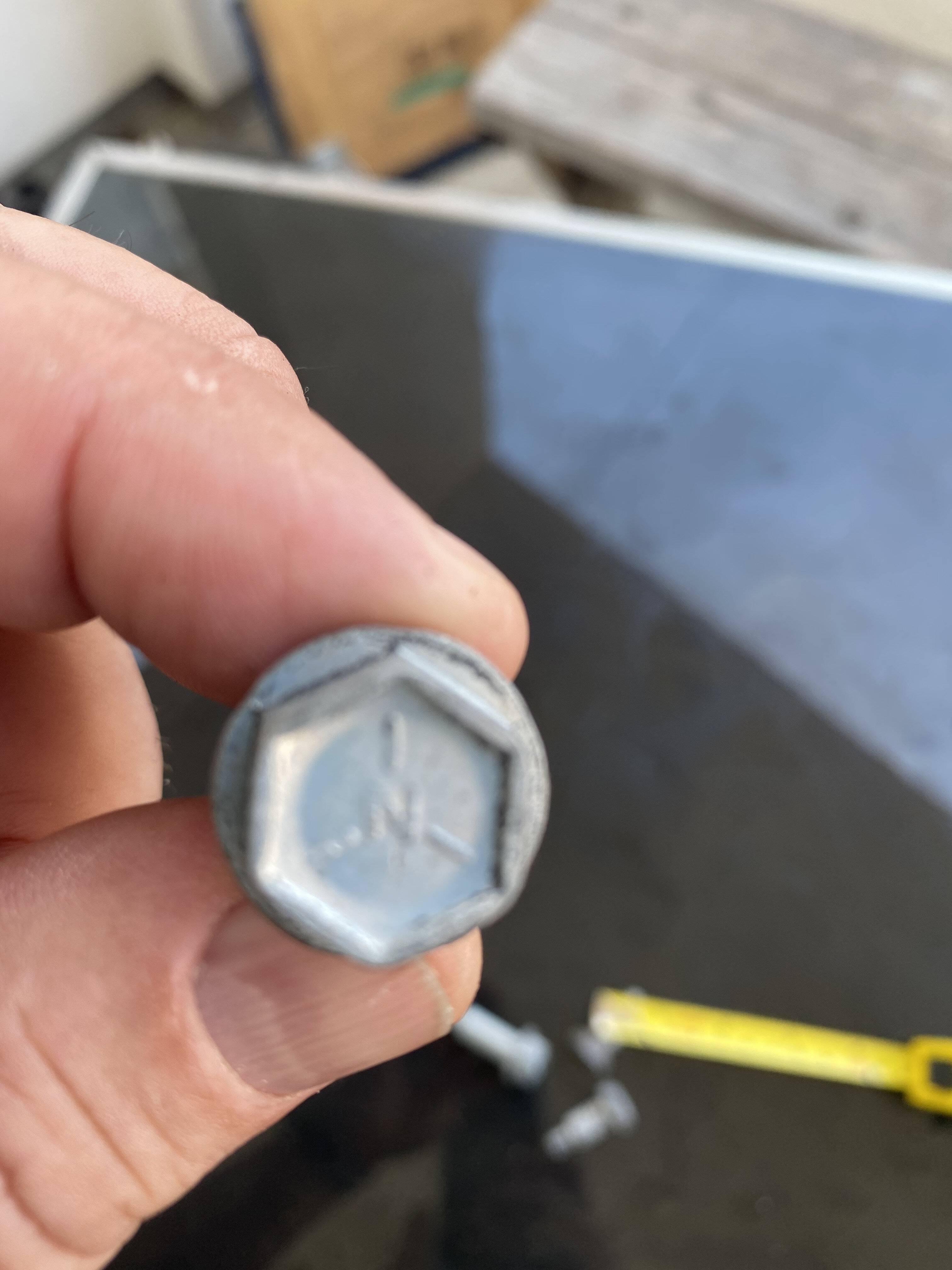

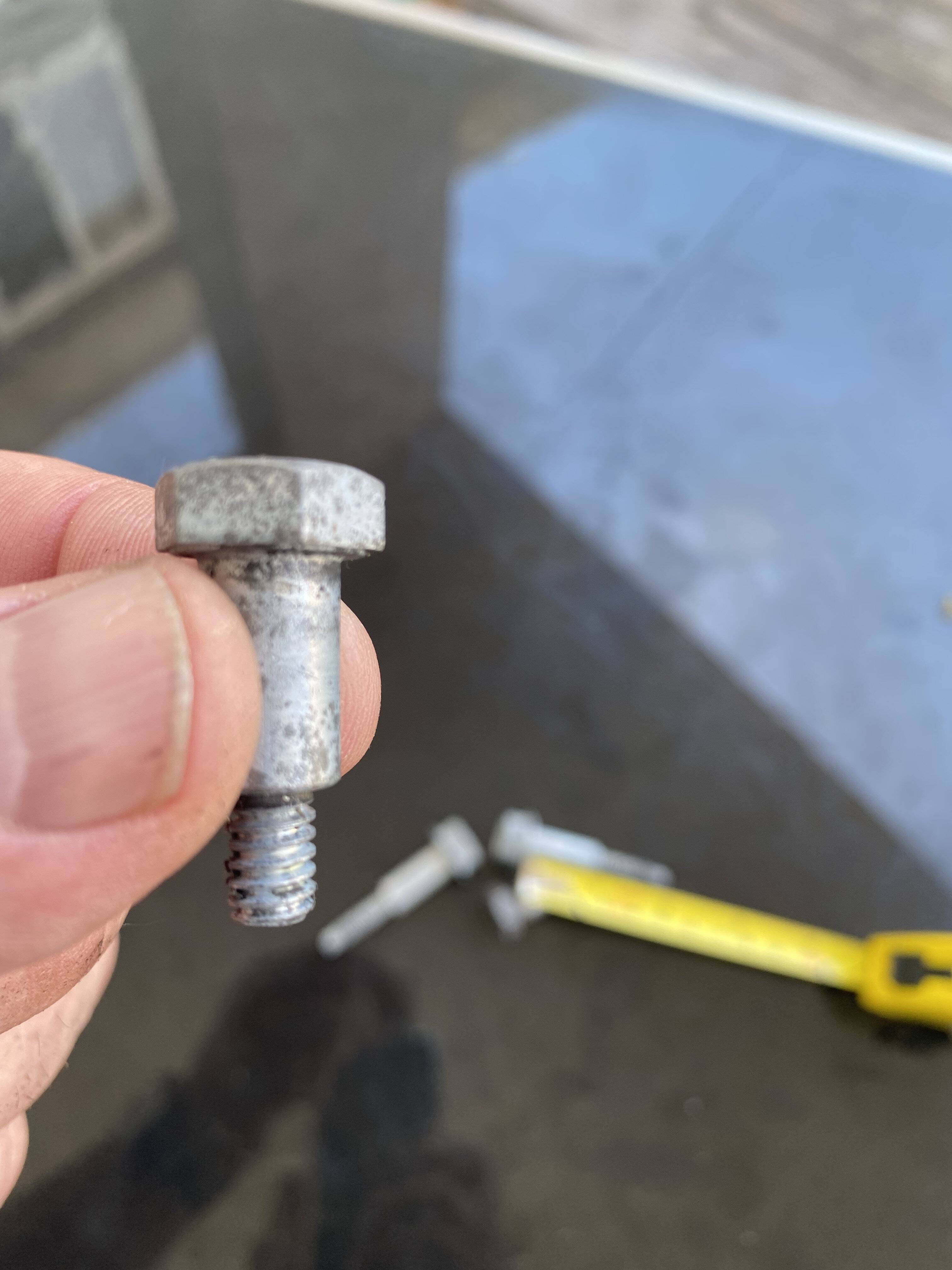

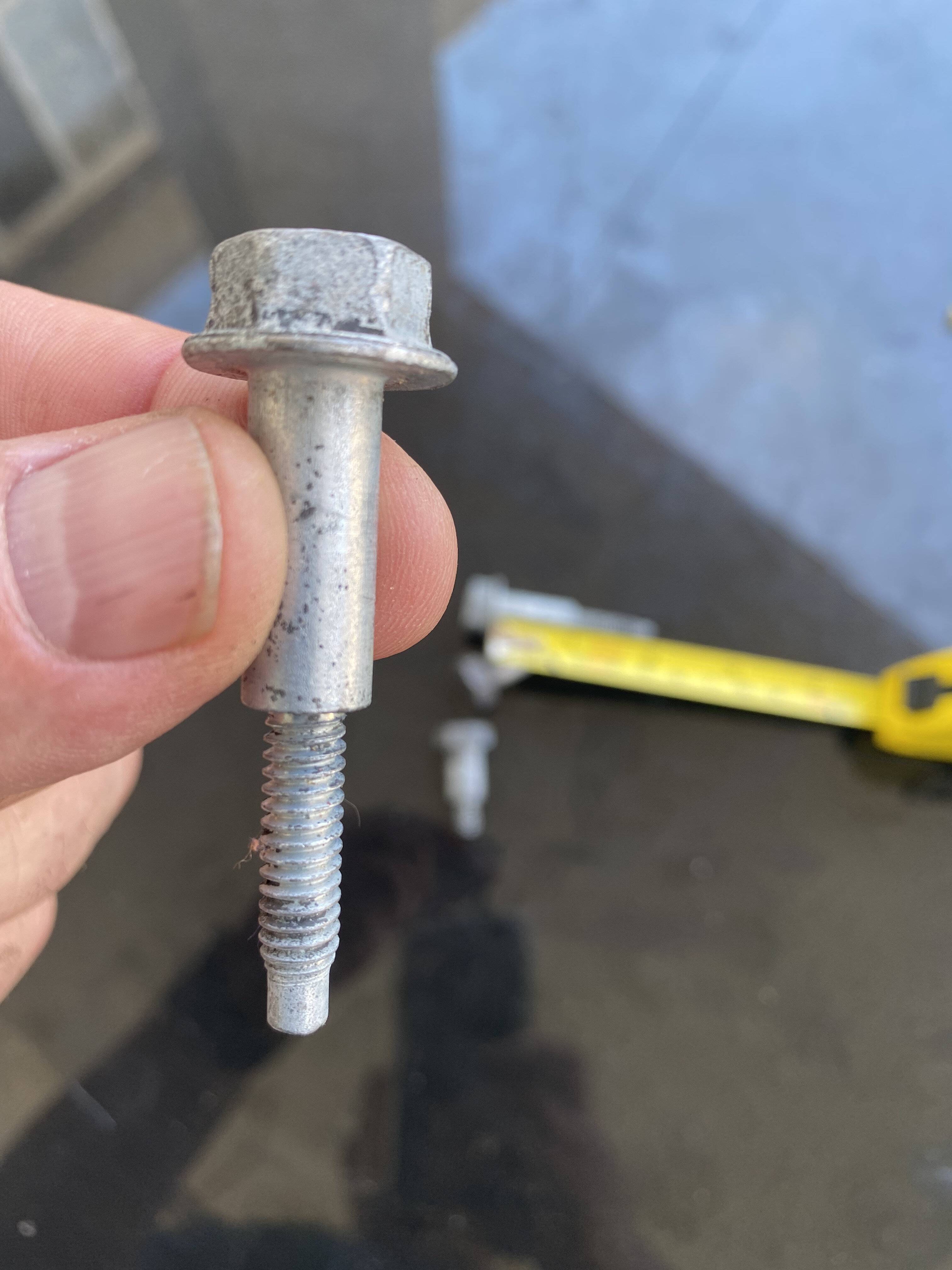

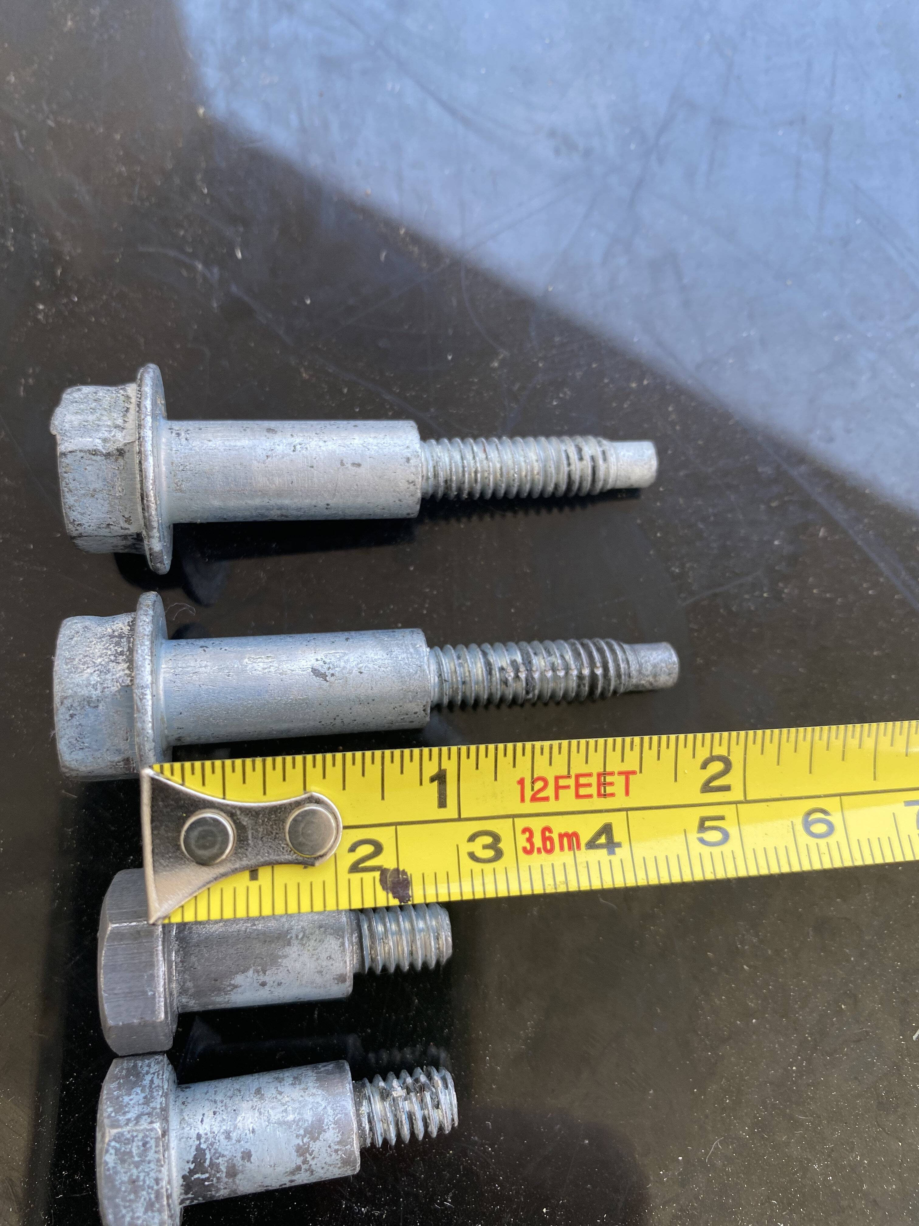

Bolt Identification Help Needed as these were in a sack of Misc. fasteners. I am removing rust on
The short one. is 1" long and. has 3-\\\ marks and TR in the middle
The longer one is 2" long with 7/8" shoulder, It has 3-\\\ and and (N) in the middle
Any help as to. where they go is appreciated

3 lines is a grade 5 and 6 lines is a grade 8. It is in the front of your Factory Service Manual. Used in various places like back seat mounts. Where you need a bolt to bottom before it goes all the way down and does not require a high strength fastener. You will know where they go when you start to remove things on your car. To find exactly where those go you would need a book like those sold by Dave Wise. These are books used to assemble a complete car and used by judges to verify factory original type fasteners.

Thanks Leo, I do have the fastener book and. Restoration/Judging Guidelines. These were in a sack full of parts from my Baracuda when I got it so, I didn't take them off.

They all look like quarter window bolts that go through the nylon positioning guides

Sorry guys, I realized I only half gave the info. I bought. a. disassembled project, 70 Baracuda. This is some of the parts that came with the car. I. can see they would be for windows now that. you mention it.
