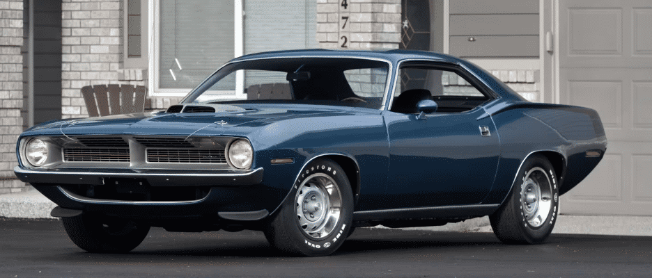

Anyone have info on the history of BS23R0B242265? It is up for sale at Mecum Glendale 2025 in a few more weeks.
The car presents as a very nice restoration but was changed from Automatic to a 4-speed at some point well before this sale.

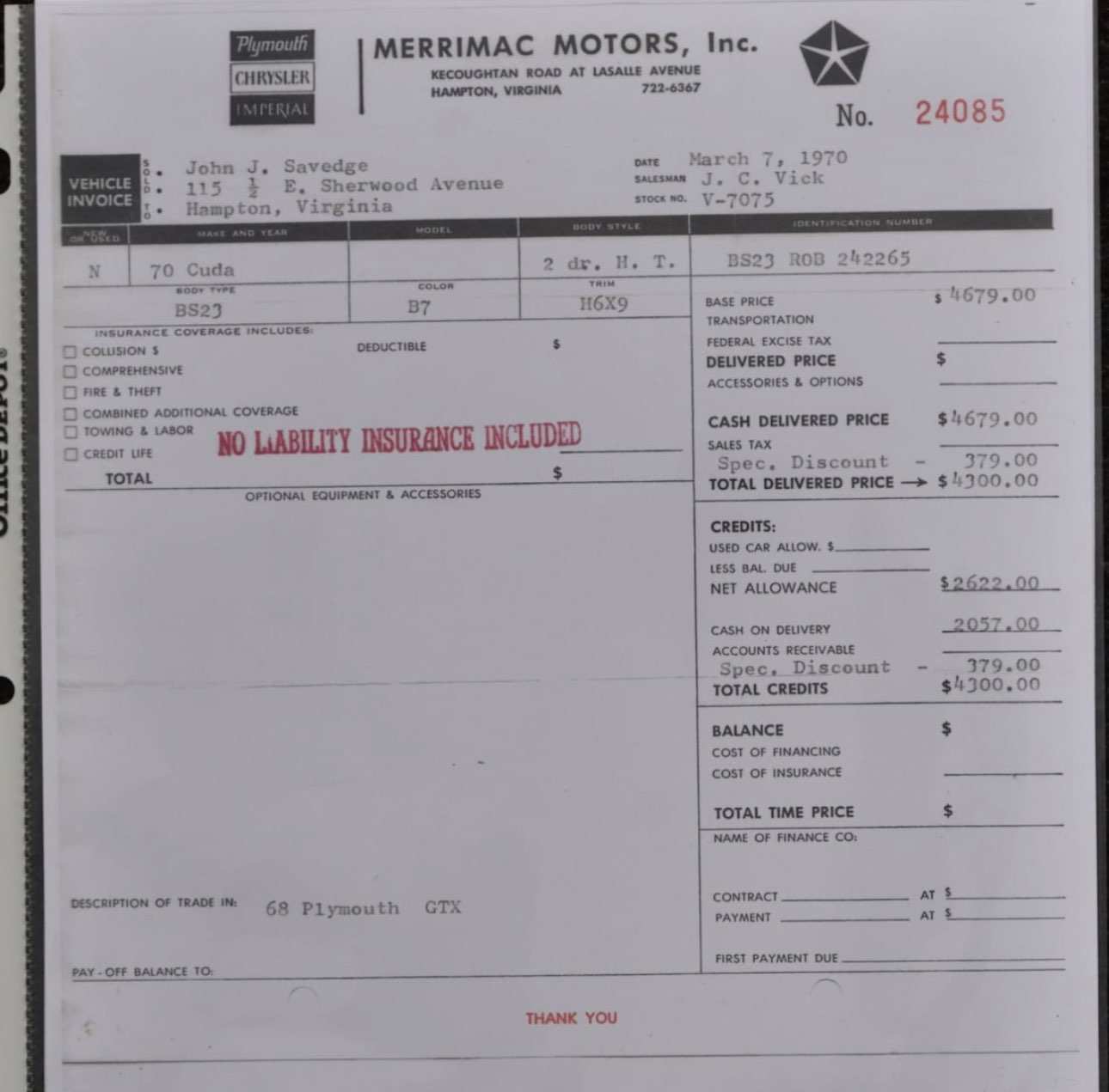

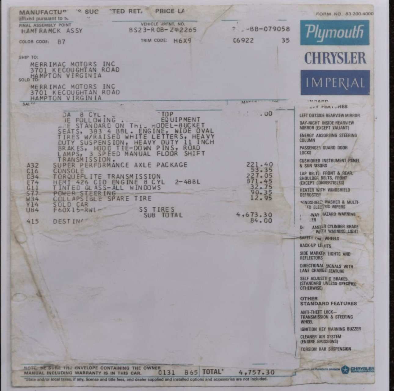

Photos in Documentation section include the Window Sticker (printed 0131) and a Sales Invoice out of Virginia.

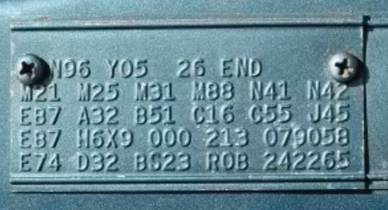

Fender tag appears to be a reproduction (note the "S" in BS23 is very odd amongst other known markers for repro fender tags).
The Scheduled Production Date of 213 is quite a bit off from the other HemiCudas built with sequence numbers close to 242265.
Most were SPD of 203 in that range of VINs. With approximately 1,339 cars built per day, the likelihood of this particular HemiCuda being 213 is doubtful.
An easy mistake without a Broadcast Sheet when seeking to make a reproduction fender tag.

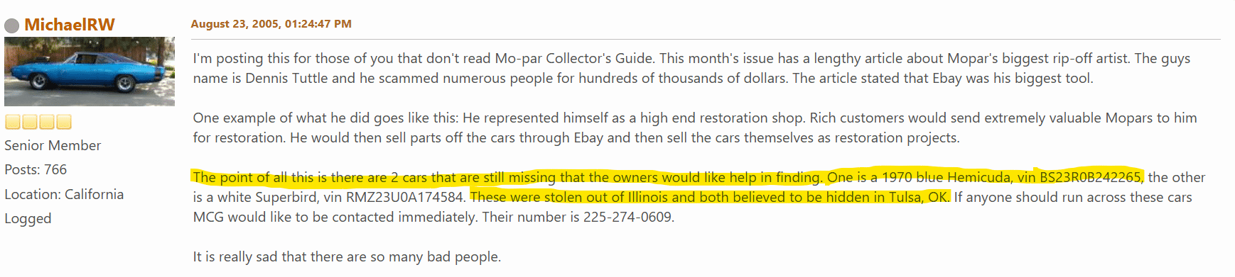

Earlier info shows this car was in a Mopar Collector's Guide article as being stolen out of Illinois circa 2005. It was possibly recovered and sold again prior to 2021 before the most recent corrections and restoration.
