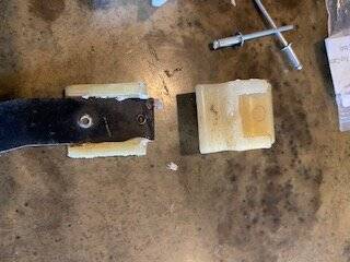

Anyone know how to remove the cover of the buckle....don't want to break it...

how did you remove it?
The metal has very small embossed protrusions that the plastic snaps over. Use a thin knife or feeler gauge or similar, between the plastic and the metal. It doesn't take much pressure it pops off easily.

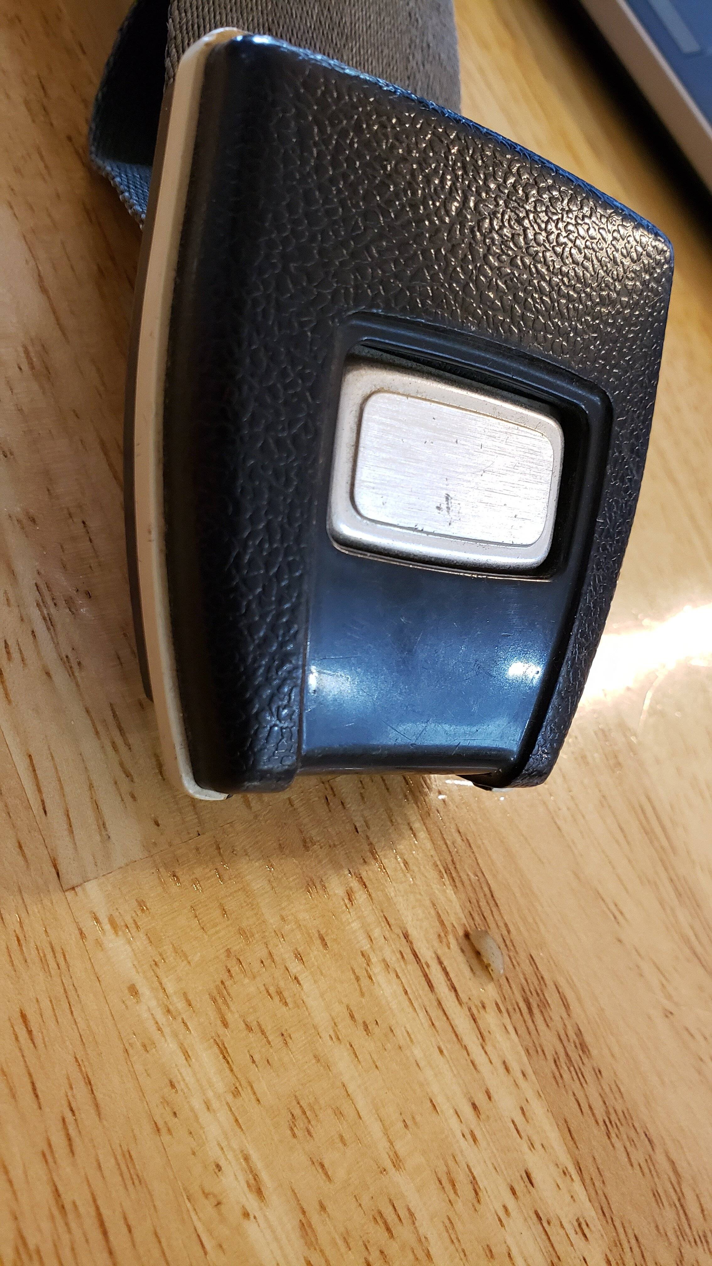

Great info, thank you. My girls and I took the convert for a cruise. After buckling up, my little girl said “daddy this broke”. The black plastic cover broke in half. Did you have to replace yours and if so, did you find a replacement??

mine did not break, however one is cracked and I will attempt glue/epoxy or what seems appropriate at the time...lol

Those are ABS plastic you can fix them by using MEK from any hardware store.
Dip a q- tip in the MEK and wet the broken edges and then press them together.
Hold for about a minute and it should be good.
You have to do this fast once you wet the edges, They should not dry.
I wait a day before putting it back together.

thank you, I will give it a shot on my seat belt. Do you think it will also work on this plastic convert clip ??

I don't know what type of plastic that clip is. Dip a Q-tip in the MEK and dab it on the plastic clip. If it softens the plastic it should work.
