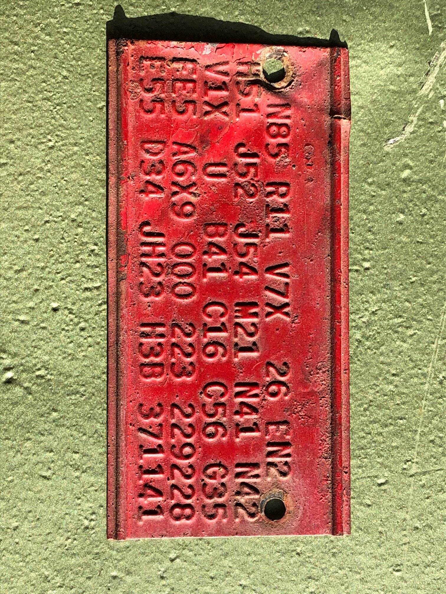

Dang, I think this is posted sideways....not sure I can rotate..... No build sheet available , rats or rot got it......thanks all

Good advice from above on decoding your tag. Free and easy.
:thumbsup: Looks to be a 73 340 Challenger w a rallye hood, in FE5 Red and black interior. Your build date was February 23. You have a rallye dash and factory AC. Looks to be a nice car.

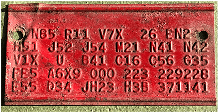

Resized and rotated fender tag with full decode.
J: Dodge Challenger
H: Priceline = High
23: 2-Door Hardtop
H: 340 240HP(net) 1-4BBL 8 CYL
3: 1973
B: Dodge Main, Hamtramck, MI, USA
371141: Vehicle ID Sequence number
E55: 340 cid 4 barrel V8 275hp
D34: Light Duty Automatic Transmission
FE5: Bright Red Exterior Color
A6X9: Trim - Basic, Vinyl Bucket Seats, Black
000: Full Door Panels
223: Scheduled Production Date: Friday, February 23, 1973 (Actual production date varies widely)
229228: Vehicle Order Number (VON)
V1X: Full Vinyl Top, Black
U: USA Specifications
B41: Front Disc Brakes w/Standard 10in RR Drum
C16: Console w/Woodgrain Panel
C56: Bucket Seats
G35: Delete Standard Outside Mirror This one needs confirmation. What mirror do you get with this code?
H51: Air Conditioning with Heater
J52: Inside Hood Release
J54: Sport Hood
M21: Roof drip rail moldings
N41: Dual Exhaust
N42: Chrome Exhaust Tips
N85: Tachometer
R11: Radio Solid State AM (2 Watts)
V7X: Accent Stripes, Black
26: 26in Radiator
EN2: End of Sales Codes
Black vinyl top too. Nice one

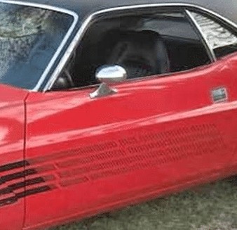

EDITED: There may be a problem with the decode of G35 as Standard Mirror Delete. Conflicting info out there. The same code also comes up as O/S LH remote chrome mirror. G35 is only for the 1972/1973 model year and G35 is not used on the earlier model Challengers.
The G31 - Standard mirror looks like this.
The G35 - Chrome Racing mirror looks like this.

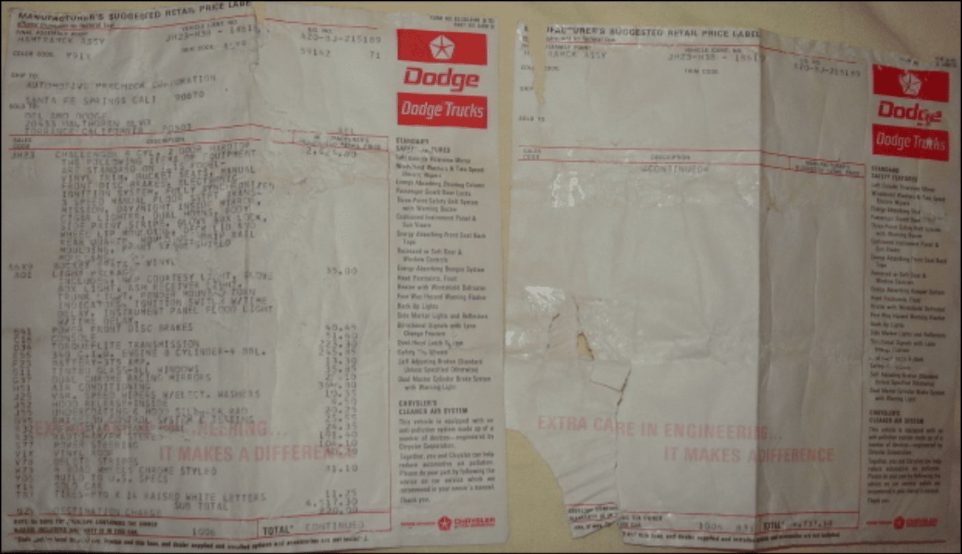

I searched for a factory 1973 window sticker (moroney label) to see what G35 actually said on the label and the price. I am guessing if you delete the standard, non-remote mirror then you would get the Outside Chrome LH remote mirror which would make the G35 code the same no matter what you called it. It may be a model year description issue only. The odd-numbered G codes are chrome mirrors and the even-numbered G codes are painted mirrors on previous model years (70-71).

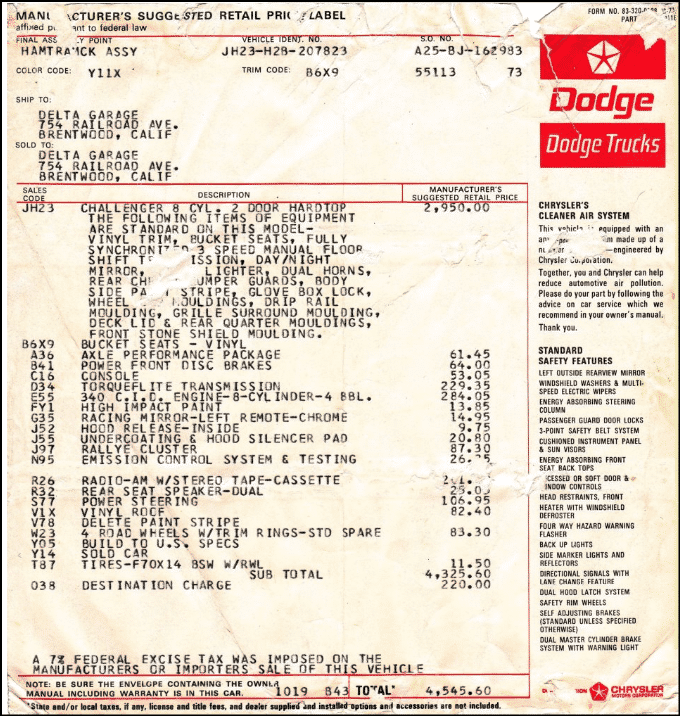

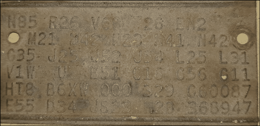

Here is a 1972 fender tag which would be G35 - Mirror O/S Left on the broadcast sheet and a different 1972 Challenger's window sticker showing G35 - RACING MIRROR-LEFT REMOTE-CHROME for $14.95. *Note this is for one Single Chrome Racing mirror on the Driver's side which would replace the standard G31 Chrome mirror.

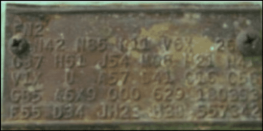

If you have a fender tag code of G37 for DUAL CHROME RACING MIRRORS, your 1973 window sticker would also have G37 for Dual Chrome Racing Mirrors and you would have G37 on the broadcast sheet. Same would apply for a G36 painted mirror code.
G37 line enlarged from the 1973 window sticker below.
And here is a 1973 Challenger fender tag with G37.

Bottom line is I believe the answer to bandit 73's earlier question on his G35 mirror code is his car came with the G35 - RACING MIRROR-LEFT REMOTE-CHROME.
