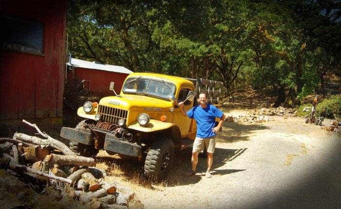

    Hi Dan. I have a 48 Power Wagon with a 360 in it, and 4.89 gears. I also have a WC53 Carryall, which is my current project.
    The current 360 and 727 in my Power Wagon was taken directly from an 80s Ramcharger. It has a cast iron, spreadbore intake. I used to have a Thermoquad carb on it, but it had issues. It now has a Holley spreadbore carb.... all in all it sucks, very weak. I have built another 360 with better compression, heads, cam, etc, which will have much better power... it has a Weiand intake with the exhaust crossover ports under the carb blocked. A mod like this might be something to consider if heat is a concern. (Get a squarebore manifold, better carb choices) I thought about an Edelbrock “Air gap” for the same reasons, no exhaust crossover, but I got a great deal on the Weiand and I gasket matched the ports... I am also ditching the carb altogether and going with a Fitech system..
    Good luck with your project, plan on the power steering upgrade. I thought I wouldn’t need it, but after a few years of driving with the original steering box I swapped it out... no regrets there!
    You will probably have to mount the radiator in the middle, or in front of, the radiator support to clear the water pump... this means the original radiator filler will not work with the cowl. I used an aftermarket radiator, which I have to open the hood to fill; and I made a fake filler tube for the radiator cap for the top of the cowl.
    Btw, the 1976 360 came in two versions, 190 & 230 hp. I must have the 190..
    I suggest you upgrade the engine before installing it...
    Power Wagon - ImageEvent
