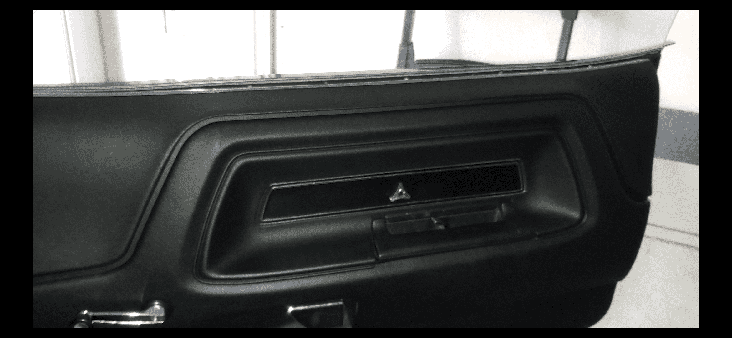

I used Herb's Parts interior paint to redo mine. I lightly sanded a couple deep scratches before hitting the panels with a few light coats of the spray-on dye. I was very happy with the color being refteshed from how faded they were. I guess it depends on your goal. For me, making them look better, although not like new, was fine. And after a few months it is still holding up well. No chips or flaking at all.

If you paint/'dye them, make sure to use the plastic primer adhesion products under the paint. They make a huge difference in how long the paint wants to stay on the plastic.
Fix the ones you have and look for a perfect set in the meantime.
