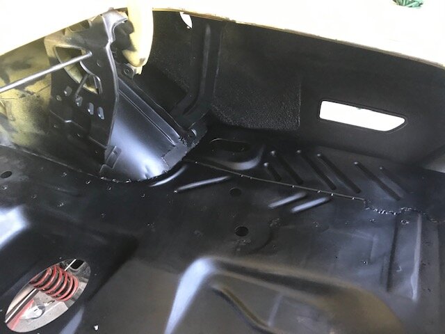

My 71 Challenger had the quarters and trunk replaced before I got it, and the trunk pan does not have a hole to route the gas nozzle from the fender through the trunk, to the tank. I have the parts, but am not sure of the exact location to cut the hole through the trunk pan. I plan to crawl under the car and see if they left any of the original trunk pan that I can go by, but does anyone have the dimensions from the quarter, rear taillight panel, etc that I can approximate if I need to go that route?

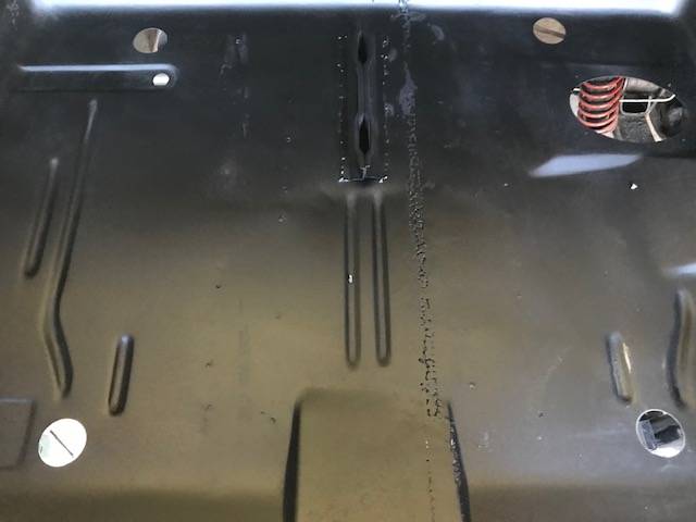

This trunk pan was done many years ago, and is solid, but it's a two-piece pan with obvious seam down the middle, and is rather crude. Do modern pans come complete in one piece and better looking? I would consider pulling the current pan if necessary, as this one cannot probably be cleaned up enough to make it nice with the seam down the middle, poor welds, etc.... The car is to be a 440 or 360 driver.
