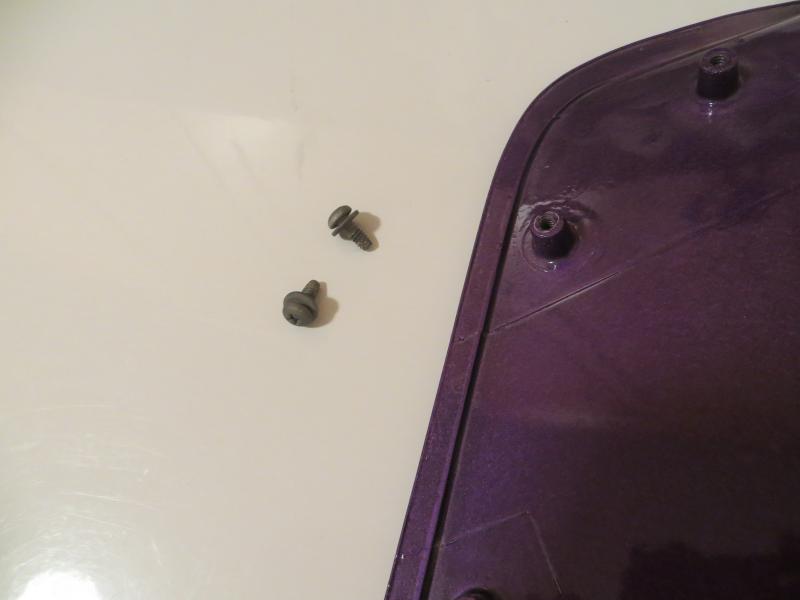

Jul 16, 2014 #1 P PDFROGMAN Member Joined Jul 29, 2010 Messages 8 Reaction score 0 hello all can someone with a rally hood, snap a picture of the bolts that hold the scoop inserts to the hood Thanks

Jul 16, 2014 #2 Adam Well-Known Member Joined Dec 25, 2012 Messages 1,694 Reaction score 758 Location Washington They are Phillips screws, pan head, 10-24 thread, 7/16ths long with a small flat washer. They get painted body color.
