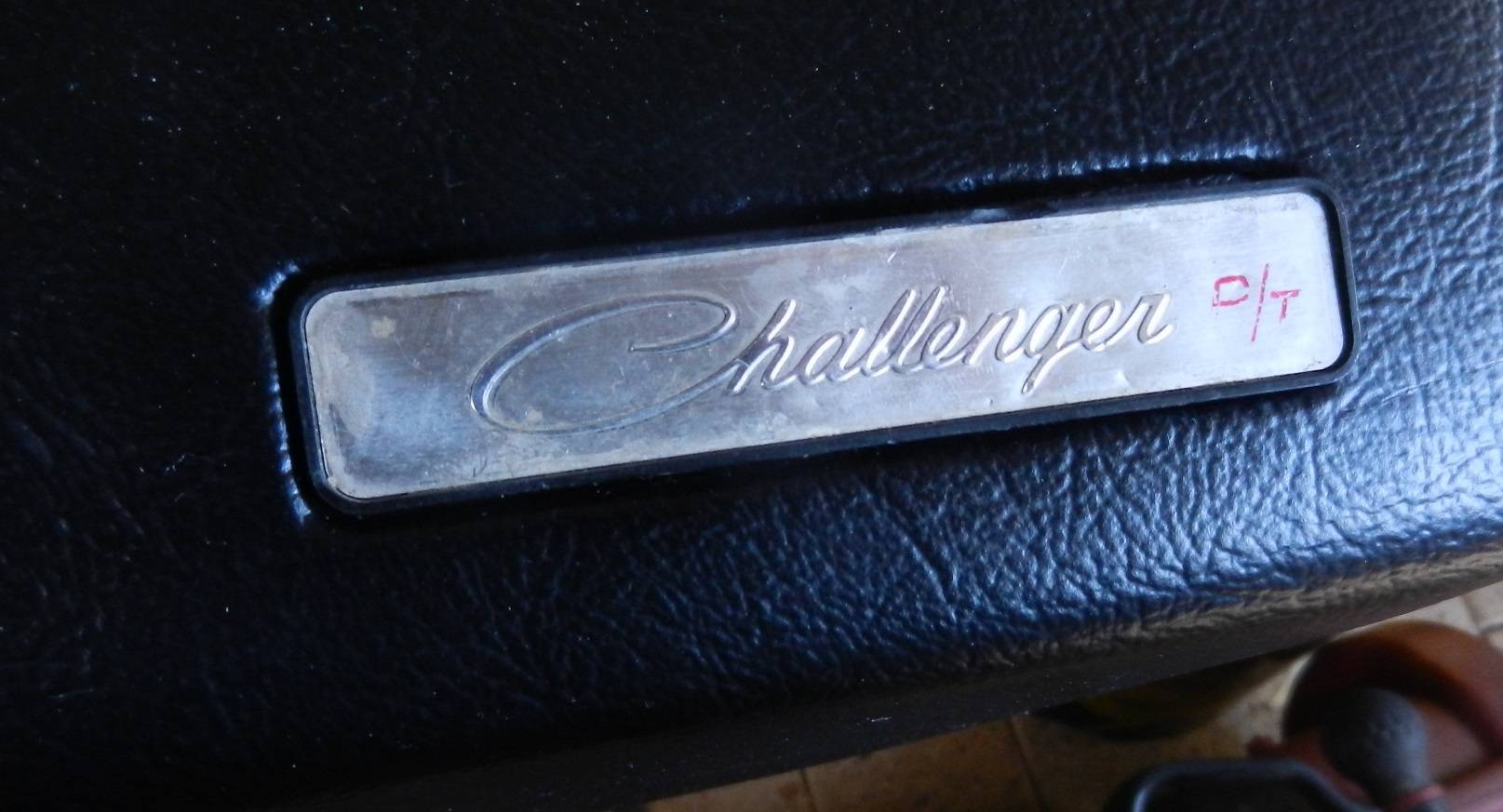

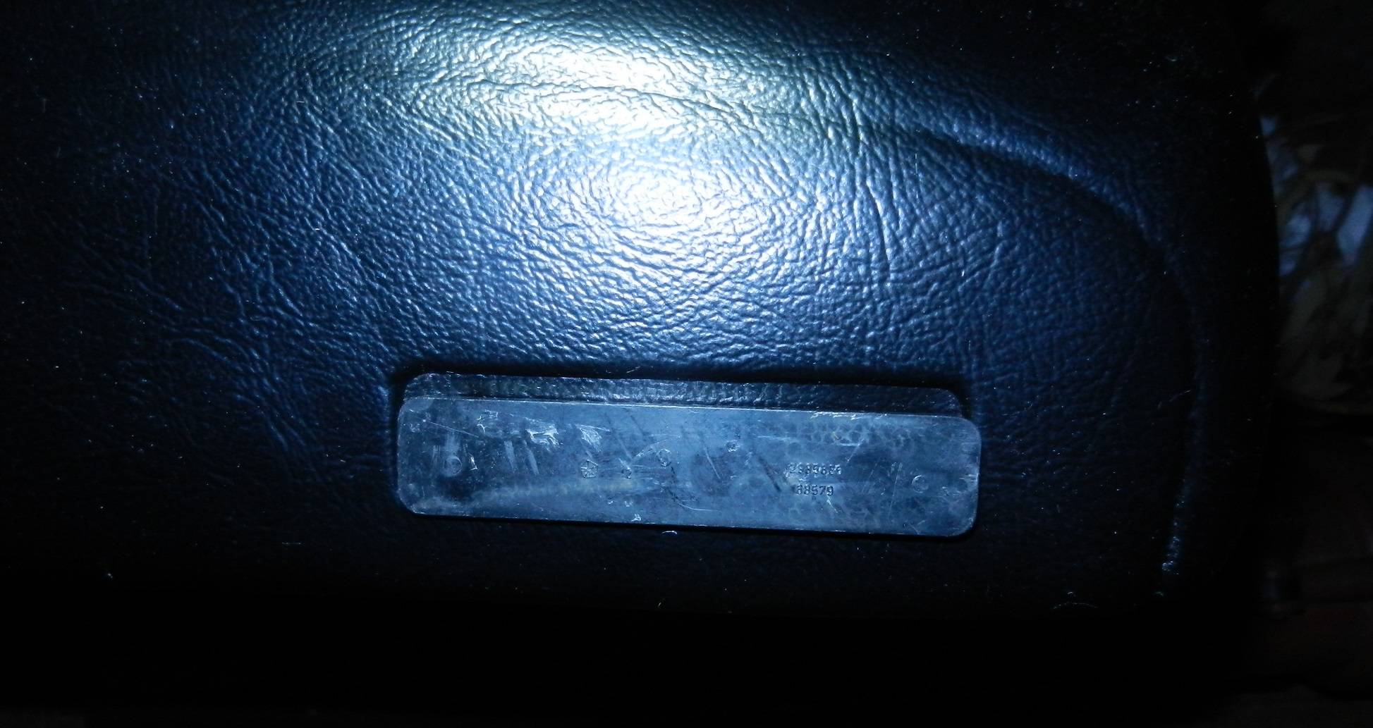

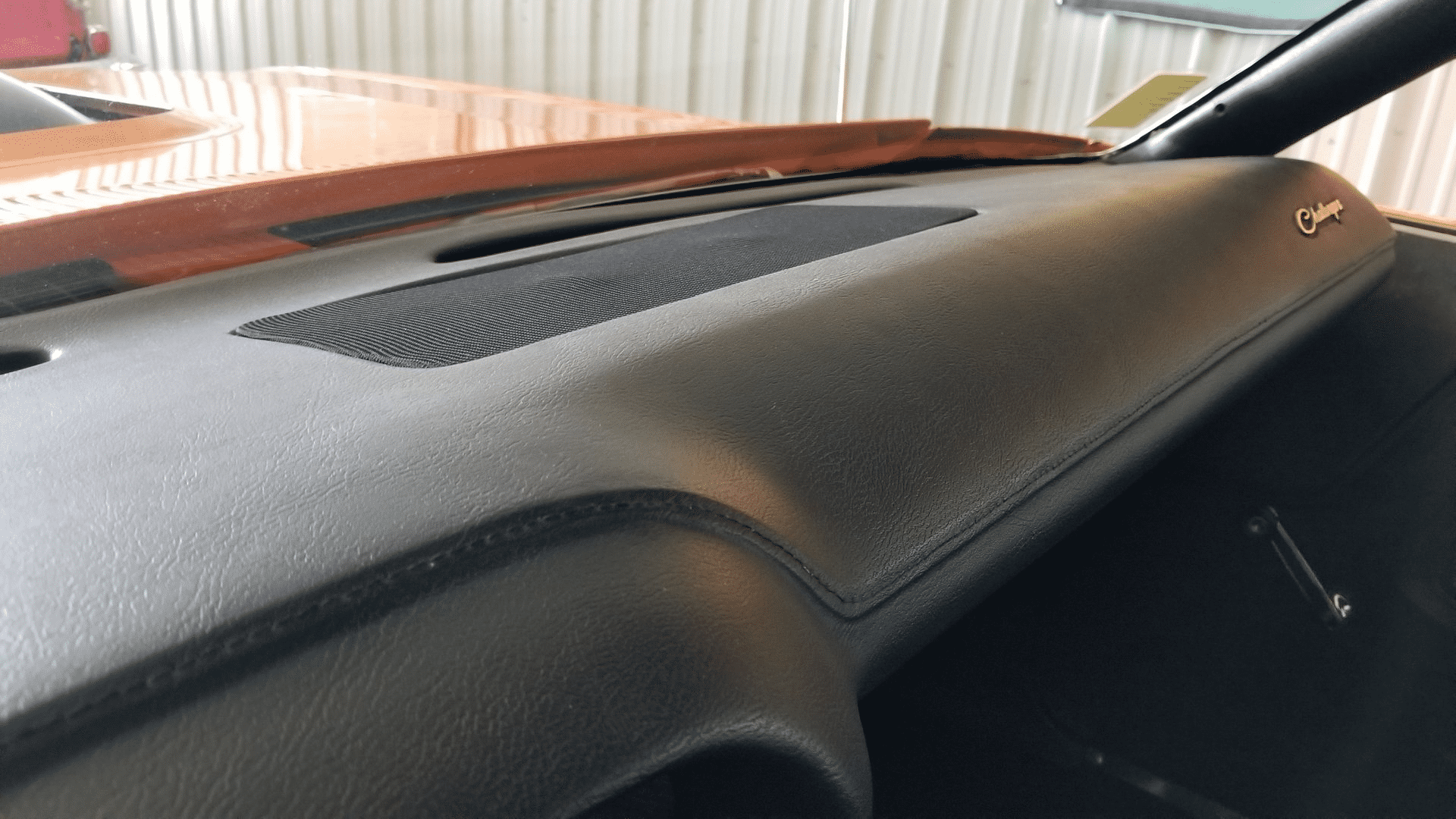

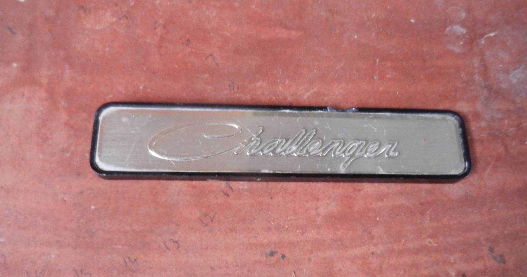

I have taken some photos. On close inspection the R/T letters now looked to have been drawn in by someone, and they were beginning to wear off. A little polish and it disappeared! But I didn't know about that when I bought it so I assumed it was a factory thing. I have measured it and also compared it to the identical badge in my 73 (original crashpad) and they are both identical and measure 3-29/32" by 13/16. So that's different to what Tony got and I assume that 71-74 Challengers were different in this respect to 71-74 Cudas. The complete dash I have that was out of a 1970 Cuda 383, but the dash cover that was on it, I have no idea what it was meant for. All I know is that this badge is too large for the indent but it would accept a Barracuda badge of the size that Tony measured. So I have learnt a few things here and thanks for the input and measurements.

Its not the badge, its the dash cap. They are pretty poor fitting when it comes to the VIN plate and the name plate, need to trim it.

I'm sure the dash caps are (or were) often a bit of a hit or miss situation - but this dash cap fits very well and even a closer than normal look will pass most tests. But it's most likely the space for that particular emblem was either not made to the correct size or it is to suit a smaller emblem. I did immediately consider getting the knife out but I don't think it would be successful. Unless I cut the ends of the black tray holding the emblem right off. And I cannot cut into the cover, it's not solid. Best thing possibly is put a spacer in and glue it onto that so that it doesn't fit in neat but sits more out than normal.
