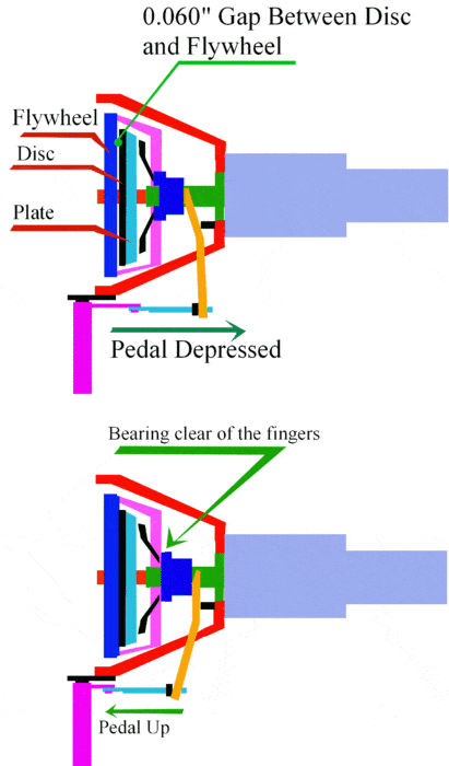

    IMO, Don't over adjust as you don't want to bend/stress any components if you bottom them out. Try to "sneak up" on it. Also have someone work the pedal while you watch all the parts for any lost motion from worn or broken components.
    .060" gap is a starting point for plate departure with a B&B. The plate fingers should not ride on the release bearing with the pedal up.

    Dave thanks so much. I will adjust tonight based on your diagram. SOOOO cool, wish me luck

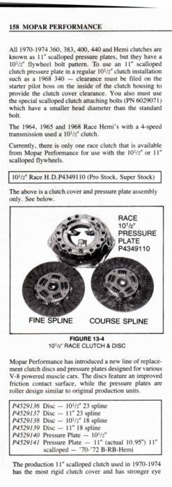

    As I understand, you should have a 130 tooth flywheel and 10.95" (scalloped) Borg & Beck (picture below) style clutch setup along with the cast aluminum bell housing for the stock major components.
    Brewers or Passion (online) can aid in identifying other correct parts for you. These include, release bearing, clutch fork, fork pivot, clutch adjustment rod set, bell housing and frame pivot balls and bushings, bell crank, and clutch rod.
