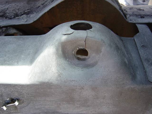

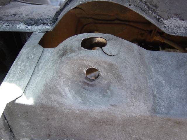

I have a blown rear shock on my Challenger, and have a set of Monroe 58577 shocks lying around. I know these are for a C-body but I wondering if anyone has used them and to what effect?
Agree. Mine had em too. First thing I threw in the trash. Standard shocks on rock auto are cheap if you need to get by.The rear shock mount is surprisingly thin, it is not supposed to support the weight of the car. My Challenger had air shocks on it which cracked the shock mount in several places, on both sides. My advice, don’t do it... if you crack this mount you would likely have to remove the trunk floor pan to fix it properly.
