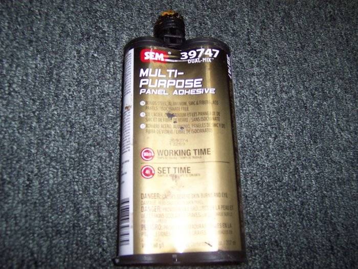

Panel bond is what I am using to attach part of my stiffing kit.It is very strong, but not recommended frame or structural work.
Lemontwist
Mar 9, 2012
41
8
This is what I use. It is extremely strong. Body supply shop said surrounding metal will tear before bonded area

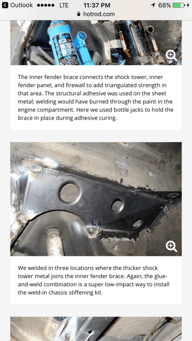

I'm looking at the same option. I have the us car tool inner fender supports ready to roll. There is a hot rod article on it.

I have used it and it works great. Go to YouTube where 3m and other companies have videos on it.

I'm gonna glue mine in for the Cuda. Thanks for setting the link I talked about btw.
Question for y'all is: do you have to remove the old fender brace that's in already to install the new ones from US Car Tool? Or do they go over it.
When I'm done I'll advise if it resolved my dreaded cowl shake. Which I call the damn front fender dance, over little or big bumps.
They install over the old brace.

Thanks much for the Intel. Just lining up my plans. Hardest part is taking off the fenders and reinstall then the obvious prep work on cleaning the joining surfaces. Luckily I put in stainless hardware a long time ago so the front should come off with a breeze.
