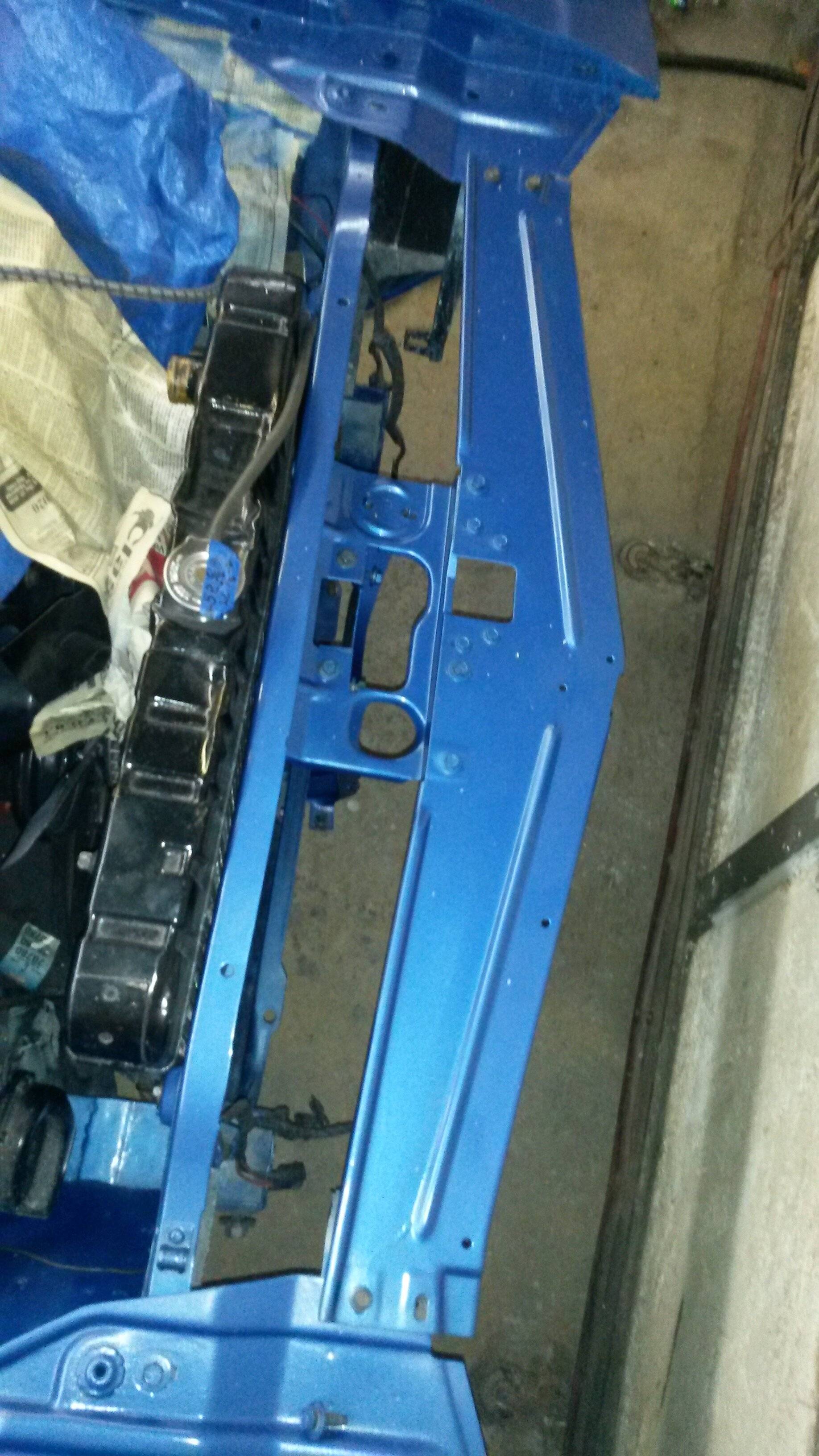

l am with Challenger 6P I believe it’s 71 Upper header panel that bolts to both fenders and with push clips hold the grill on.

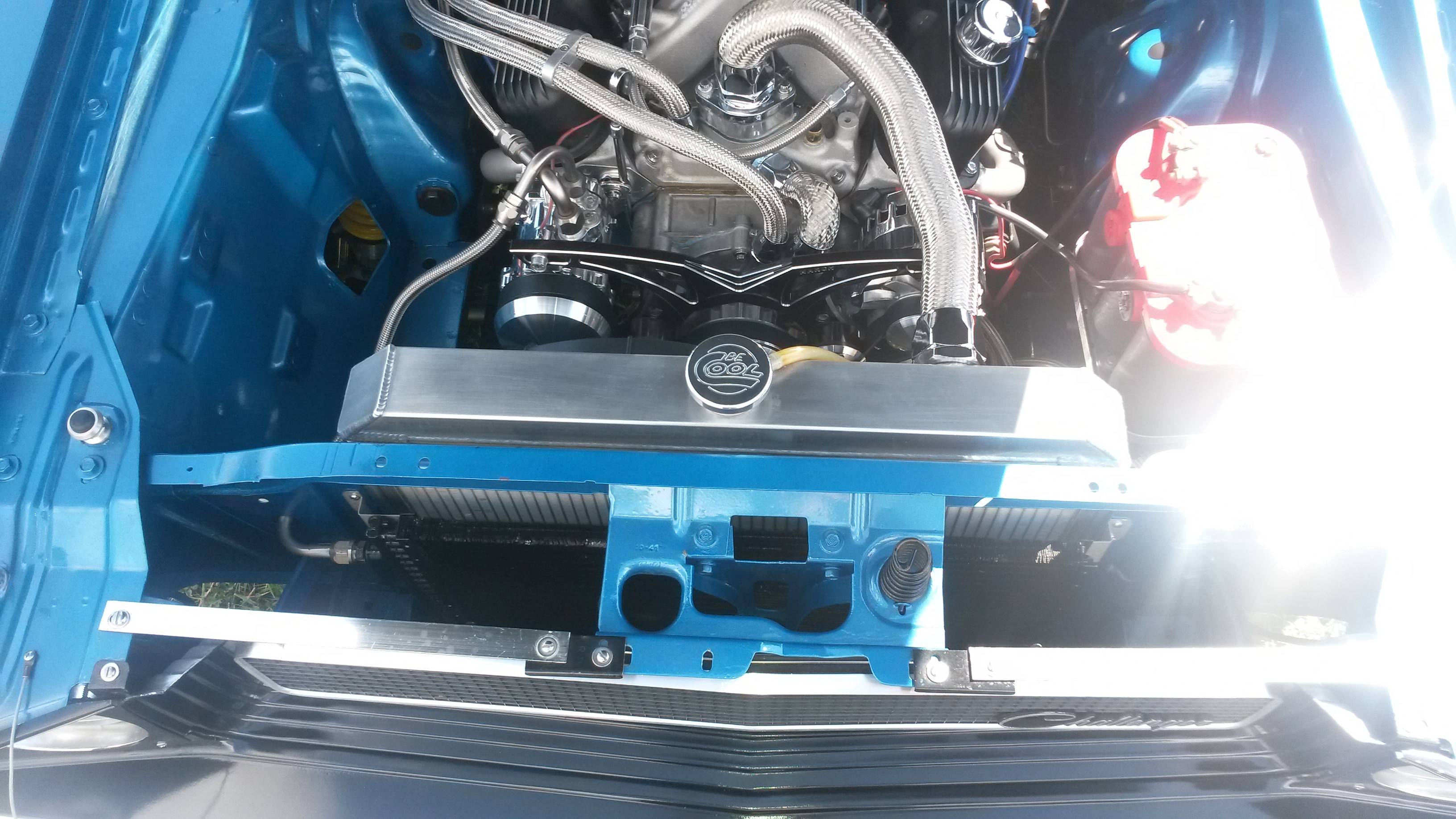

OK! I can't take it.Here is a 70 and 71 if this is what you are referring to.

Thats it, the bottom picture. So only for a 71. The 70 only uses the vertical support that is in the catalog. Well thats great another mystery solved. I will probably clean them up and post them for sale since I don't need them. BTW, that is a nice looking engine compartment on the 70 picture.
