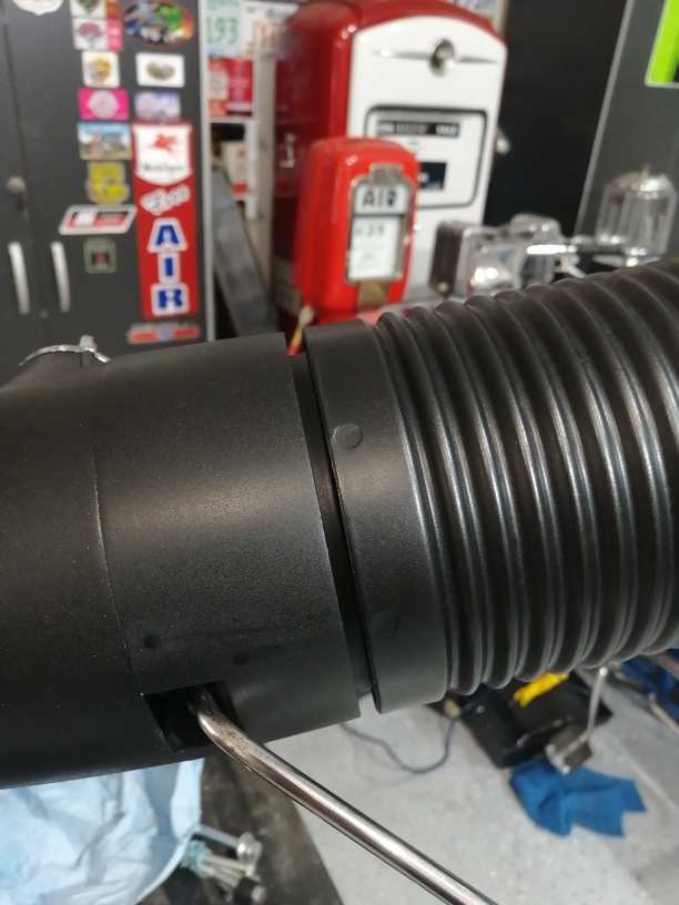

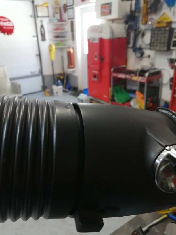

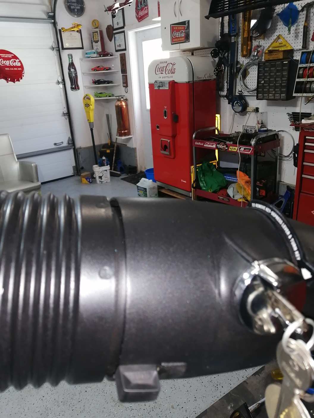

Feb 11, 2025 #1 C Copilot Well-Known Member Joined Jan 11, 2024 Messages 72 Reaction score 59 Location Canada Good evening gents, I'm finishing up the restoration on my steering column and the crush can gap seem a little to wide, not sure the gap before i took it apart. It a auto column out of a 73 challenger.
Feb 11, 2025 #2 G gran coupe john Well-Known Member Joined Aug 15, 2023 Messages 906 Reaction score 267 Location Ohio When I did my column, had to tighten the nut to get the right gap. My opinion gap should be a bit smaller.
Feb 12, 2025 #3 EV2RTSE Well-Known Member Joined Dec 13, 2013 Messages 475 Reaction score 341 Agree, take a look at this original one for comparison. FOR SALE - 1970-74 Challenger Steering Column Floorshift
