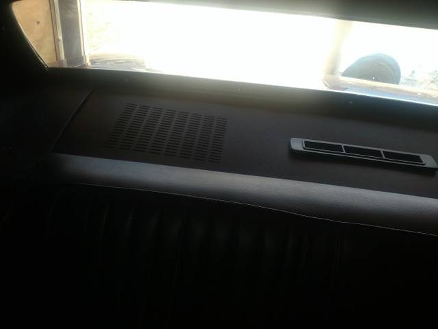

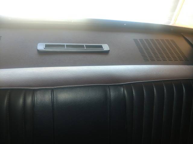

Does anyone have a picture of a original rear package tray for a 1970 Cuda with a rear defroster that they can post. I'm looking to buy a repro package and can't find one with the defroster cutouts.

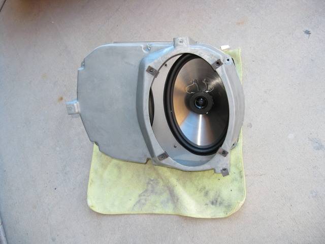

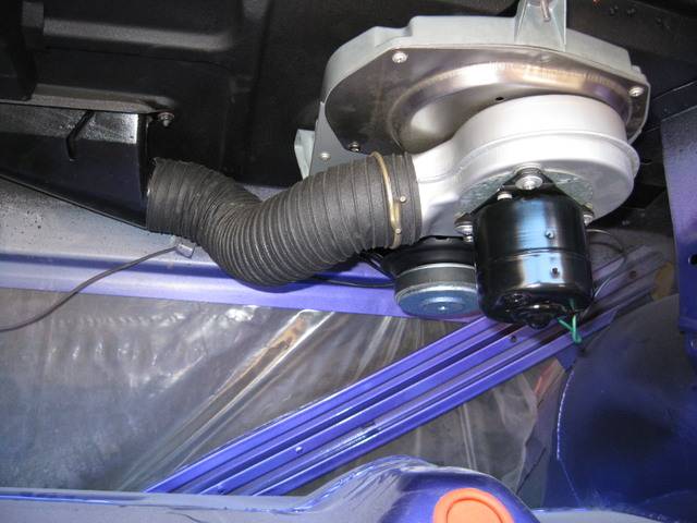

I am pretty sure the center defrost vent cut out is the only difference. You can put the board into position and mark it exactly from underneath. The air which exits the center vent is drawn in through the right side speaker holes. This one has the speaker adapter, without it the blower just mounts to the speaker cut out.
