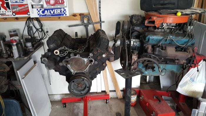

    Found a long block Magnum 5.9 in SW Arkansas for $100, so my two oldest boys and I took a little road trip to bring back another piece of the puzzle. IMG_20190604_200921_01.jpg
  5. J72440rallye
    J72440rallye Member
    Messages:
    20
    Likes Received:
    14
    Joined:
    Oct 2, 2019
    Location:
    Oklahoma City, OK

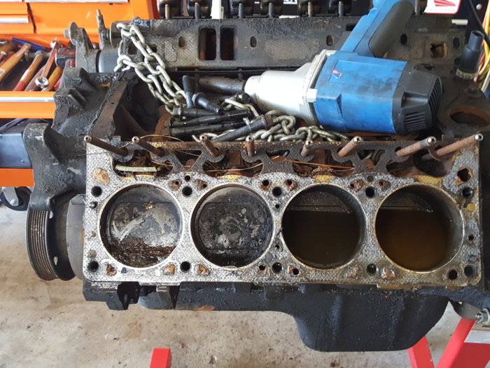

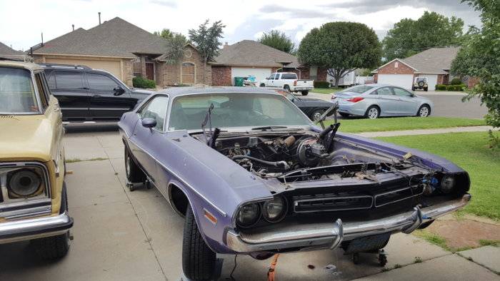

    The engine had been sitting in the bed of a dodge pickup uncovered and without an intake for a little while. She was full of water and locked up. With a littler persistence she started to rotate. Just dropped it off at the machine shop last week. Both of the stock heads are cracked (as expected), block to be prepped with the usual treatments and punched if necessary. The owner of the machine shop has sourced some EQ manifolds with the LA intake pattern and I will re-purpose the dual plane Mopar intake off of the 318 that came out. The plan is to assemble the engine with my oldest son (12). IMG_20190605_131159_01.jpg IMG_20190608_175041_01.jpg 20190608_184924.jpg

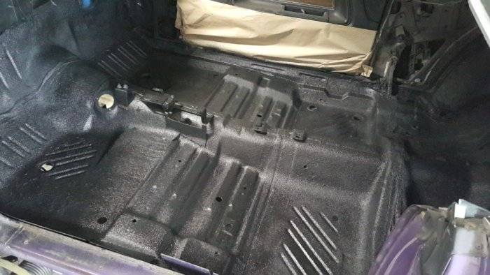

    Prepped and shot Raptor liner on the cabin floor panels. This stuff is tough and hopefully a little bit of insurance against rust. IMG_20190803_190321_01.jpg

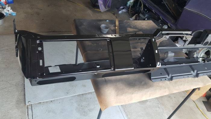

    Prepped and shot the dash frame, glove box and ash tr 20190809_171509.jpg ay with a kit from SEM in hot rod black.

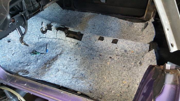

    I saw this product featured in a video from Auto Resto Mod called Bonded Logic. They showed good results with a low product cost. It is a thick foil backed insulation made from recycled denim and I picked it up a 4' by 24' roll on Amazon for around $75. Definitely a lot easier on the knees while crawling around the interior. 20190919_181914.jpg
    • Like Like x 1
    • Thanks! Thanks! x 1

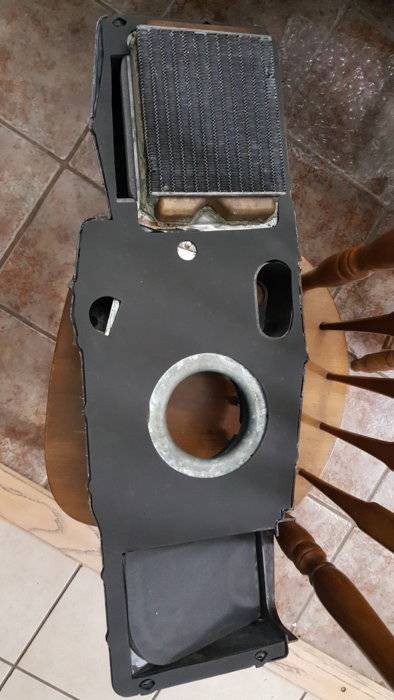

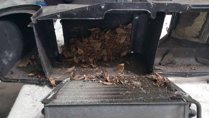

    Picked up a seal kit for the heater box and was very glad that I did. The heater resistor was surrounded by a pile of dried leaves that had blown into the box! The local radiator shop checked out the evaporator before I put it all back together. Very happy with the kit and instructions from Detroit Muscle Technologies. 20190610_010548.jpg 20190615_000847.jpg

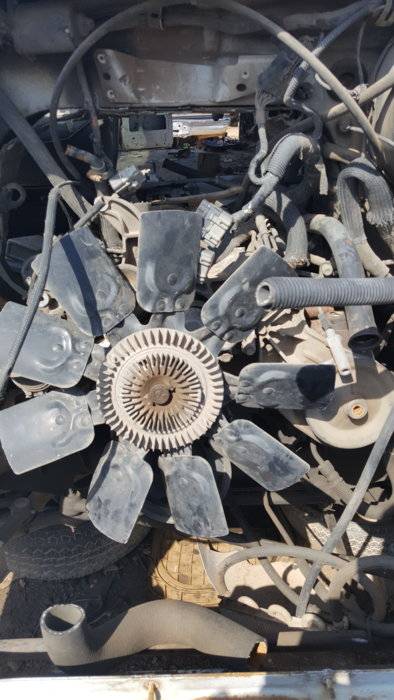

    Hit the local Pull A Part and found a 1998 B2500 Dodge van with a Magnum V8. Pulled the accessory brackets, water pump/fan/clutch assembly and water pump. I had read somewhere that the van setup is better for an E body swap, let me know what your experiences are because there are plenty of pickup brackets to choose from if they are a better option. I also grabbed an alternator and starter from a 96 Ram. There is a local alternator repair shop that has done amazing work at an unbeatable price for us in the past, so they will be getting the alternator and starter to work their magic on. I will be installing a new water pump and fan clutch but wasn't able to separate them at the yard. More options at the home base. 20191002_142511.jpg

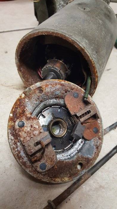

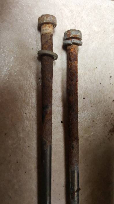

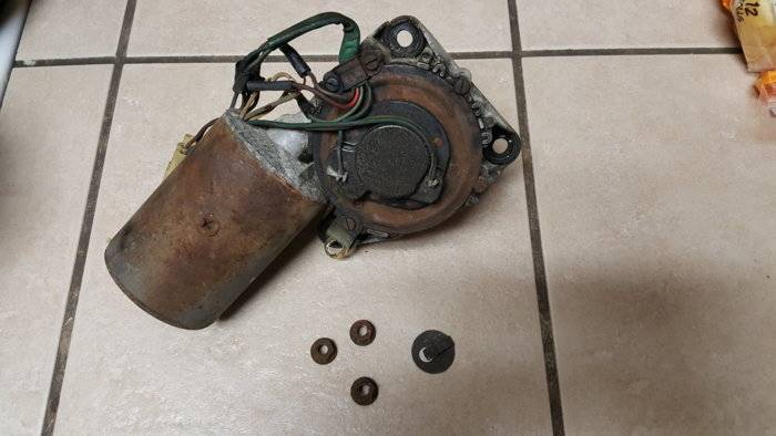

    Ordered up some gaskets to go through the wiper motor. Little bit of crust in there and will have to drill out the side barrel screws, replace them along with the long screws. More to come in this section. 20191004_182432.jpg 20191004_183227.jpg 20191004_183057.jpg

    My understanding is that the power steering mount off the vans work better in A bodies because it keeps the pump from hitting the battery tray. I can not imagine it being a bad thing for the E body as well. I am doing the same conversion with the 5.9/46RH too. I am stroking mine to a 408, and most likely convert mine to a LA V-belt. Looks like a great project !

    “I will re-purpose the dual plane Mopar intake off of the 318 that came out.”
    Aren’t the 318 intake ports smaller than the 360 ports?
  18. J72440rallye
    J72440rallye Member
    Messages:
    20
    Likes Received:
    14
    Joined:
    Oct 2, 2019
    Location:
    Oklahoma City, OK
    Good question, I had assumed that 318, 340 and 360s shared the same intake manifolds (aftermarket). The one that I was going to re-purpose is a Mopar aluminum dual plane that was installed on the 69 318 that came out of the 71. I asked the machine shop to order in a set of the EQ heads that used the older LA intake bolt pattern and angle mainly as a current cost savings with future options. I just ran a quick search on the Summit Racing site and they have their intakes listed as compatible between the 318, 340 and 360 LA family of engines. Interested to hear if someone has experienced this not being accurate. I grind and file aluminum for a living, so I definitely won't shy away from port matching the intake a bit if needed. On the head side I may smooth the ports out a bit without getting aggressive since I don't want to be surprised by a coolant passage photobombing my intake runner. Especially on a new head.

  20. Adam
    Adam Well-Known Member
    Messages:
    1,251
    Likes Received:
    539
    Joined:
    Dec 25, 2012
    Location:
    Washington
    The EQ heads are excellent pieces. I have a set on a 360. I would just open up the intake ports on your 318 intake to match the heads, if they are not the same. Some 318 intake manifolds have the same size runners as the bigger manifolds with a small lip at the edge of the runner; easy to remove if it hasn’t already..
