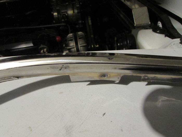

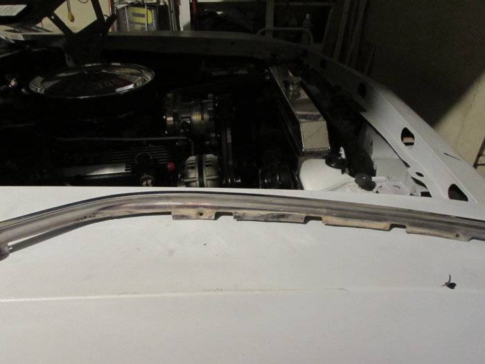

    Here are some pics of my drip edge molding I have off my car right now. Rod

    Thanks for the pics. It really helps.
