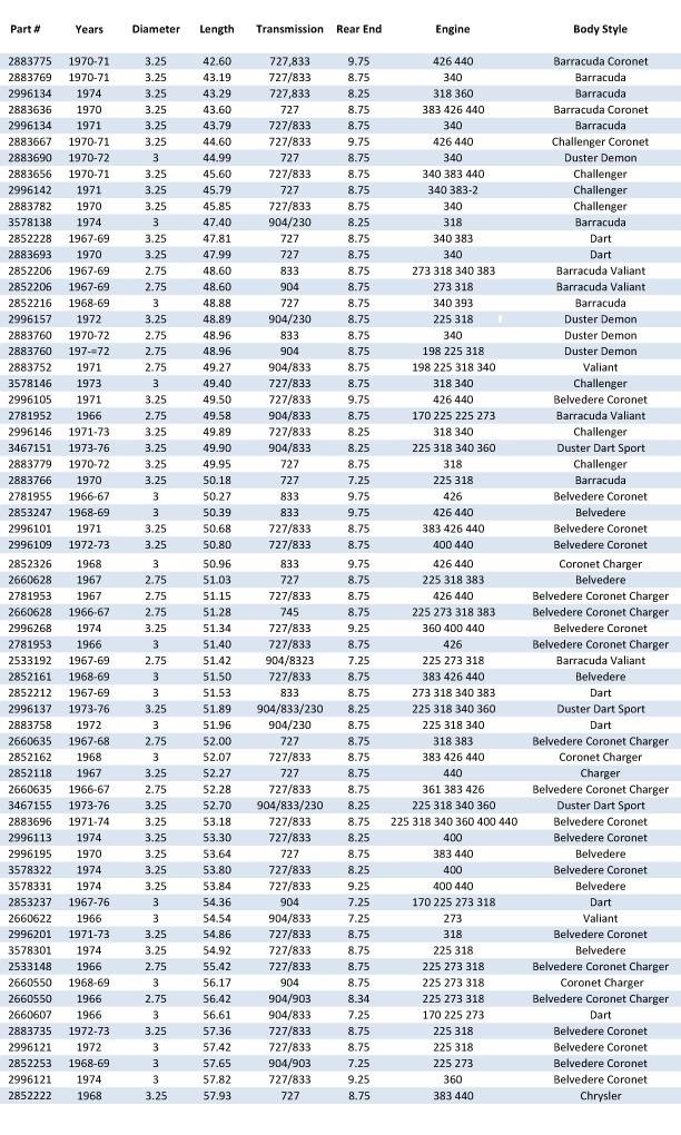

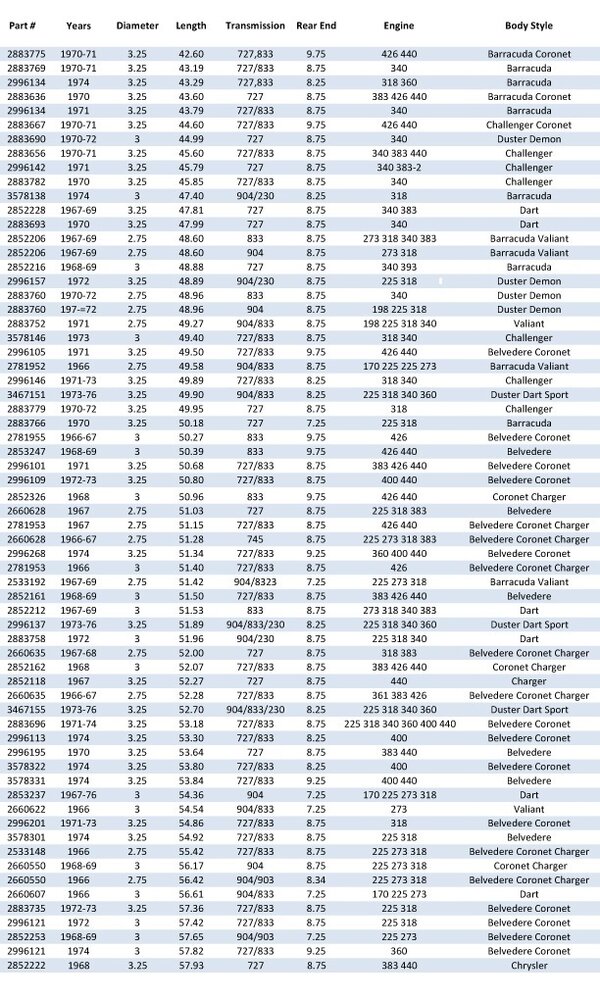

I just replace the 7 1/4 rear end with a 8 3/4. I have a 70 Barracuda, 360 with a 727 trans. It looks like I need to shorten the drive shaft. Does anyone have the specs for the length of the drive shaft? I'm going to measure it but I want to be sure I'm within specs. Thanks.

Should be 43.29 from c to c on u joint according to the chart! That would be for stock ride height. I would make sure I had 3/4 to 1 inch of slip yoke at the trans tail housing.

Here you go...
Thanks for the info. Moparleo sent me a spec chart for the rear ends. You are correct on the length.

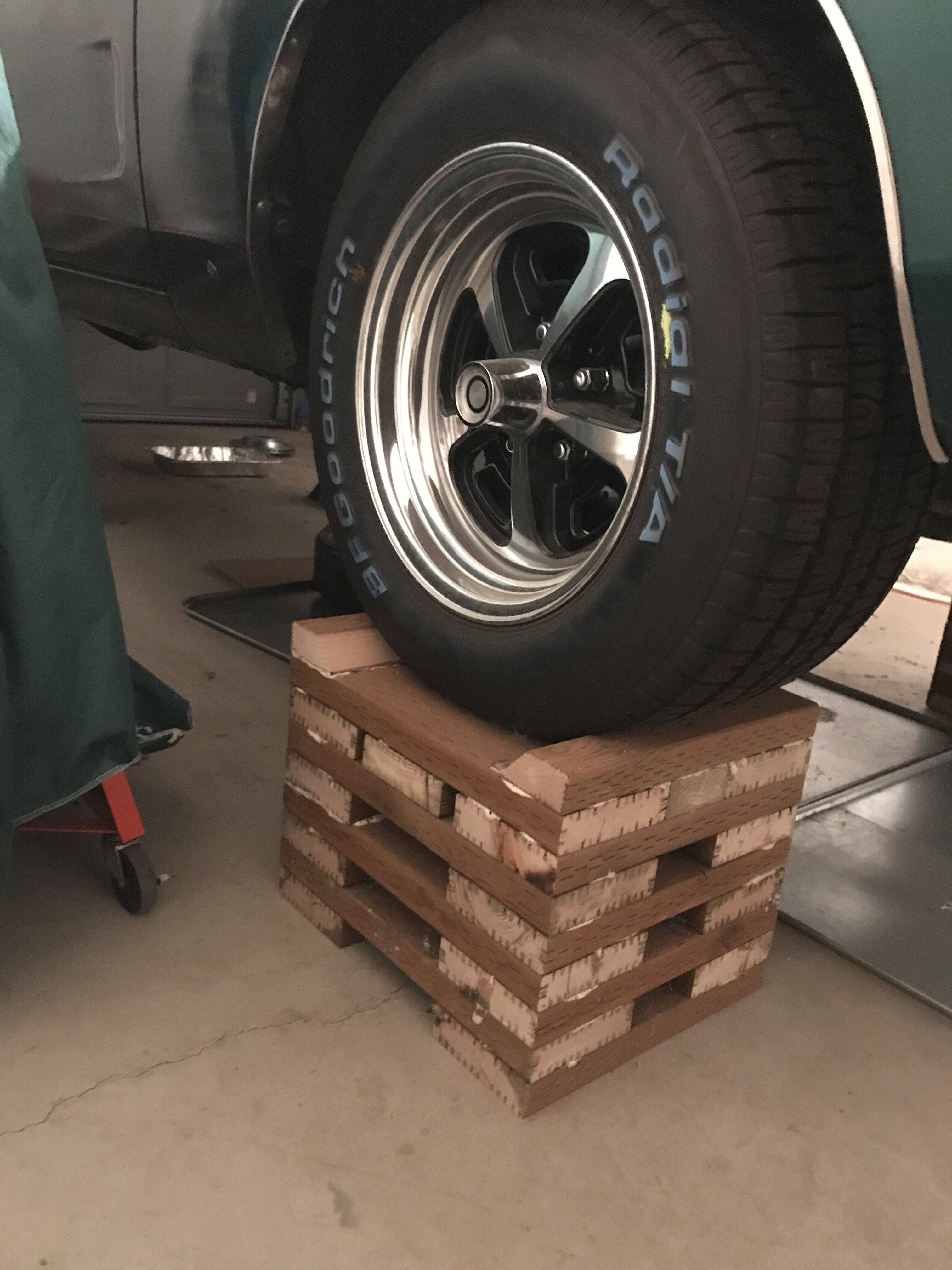

Thanks, I'm going to measure the length but it's a little hard to measure it when the car is at ride height.
To keep my car at ride height, I made cribbing for each wheel to sit on while working on it. Cheap and very strong.
