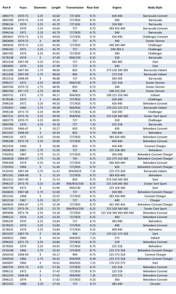

Who measured the car for the driveshaft ?
What engine/trans/rear does it have ?

OK You gave him a measurement, but where did you get that number ?
Again, what engine/trans/dif are you running ? How can we know what is acceptable without knowing what you are running ? More details...

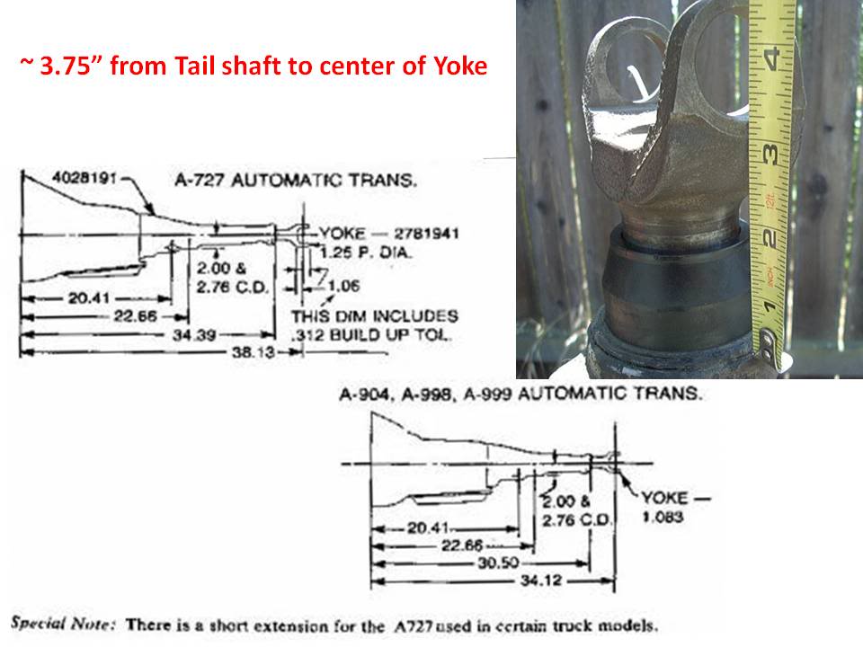

I posted the factory part numbers and dimensions. And here is a cart for doing your own, normally used on a custom application.

I got the measurement from the chart above. 383, 8 3/4 727. Just want to know if 1 1/4 from bottoming out in the transmission is acceptable.

Ok so the whole story is this driveshaft guy came highly recommended. I told him to make it 43.6 c-c. I get it back home and it’s 43 1/8 🤦🏻‍♂️ I called him up, he told me it’ll work. From what I know the slip yoke is supposed to bottom out and be pulled back 1” and that’s where it should sit. Mine pulls back 1 1/4.
