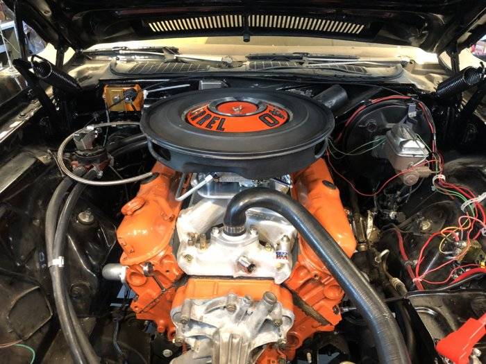

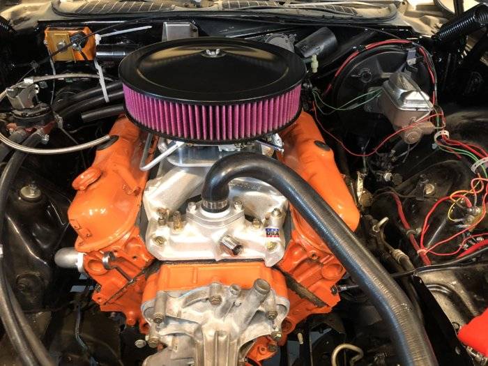

    Air gap on 71 challenger 340. Removed under hood insulation, used dollar store play doh to verify It cleared, about 3/8” gap. I also have a cool carb spacer between carb and manifold. Can’t remember how thick spacer is. Decided to run aftermarket air cleaner bottom picture.
