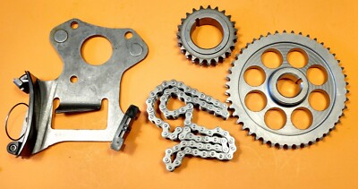

Put a chain tensioner in there when you put the timing chain in. From what I know it will fit under the timing cover. I have one in my car. Block is a 71 340 and it fit perfectly under the cover without any modifications.
Here is the whole kit with timing chain set.

Great suggestion Mrmopar340! The chain tensioner for a 3.9l magnum V6 is exactly the same and sometimes you can pick those up very cheap.
I used a Cloyes Billet double roller and that tensioner. Has worked like a charm. Good job on better price. I see you are as frugal as I am.

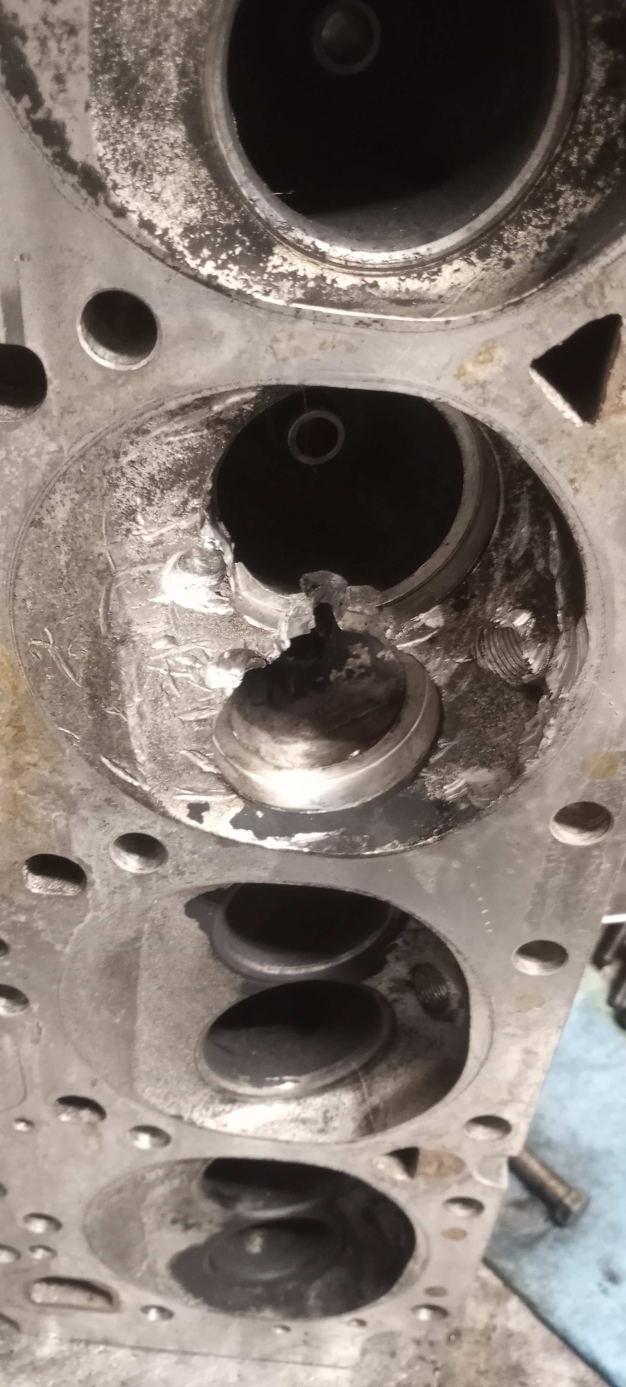

- I've seen first hand the poor quality of Speedmaster (Chinese Made) & Edelbrock (Still U.S.) Unfortunately these brands both seem to be catering toward the Online Retailers, (Quantity vs Quality). (Competing on price is always a Race to the Bottom).
- Finally if you're getting somebody to build your motor MAKE DOUBLE SURE THEY AT LEAST BENCH RUN BEFORE SHIPPING! (Stupid me - I only assumed it would be done). Recently paid a guy Mega Bucks to build me a 408 Stroker that seems to run really well but leaks like crazy...then blames me for complaining!!

Am I correct you are an Engine Builder? Did Edelbrock honor your warranty??
In my situation there's only a few hundred miles on the motor. Not sure whether it's a parts issue or poor workmanship from the builder...or both.
