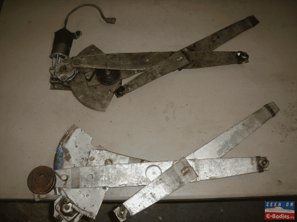

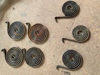

Below is an E body front regulator with the spring that looks identical to the 4 on the left in my pic below that. The 3 on the right in my pic have one less coil and I believe are C body rears although I have a few front regulator assemblies that are complete with the smaller spring. If you’re talking E body rear quarter windows those springs look like they have 2 or 3 fewer coils than these but I don’t have any of those.
