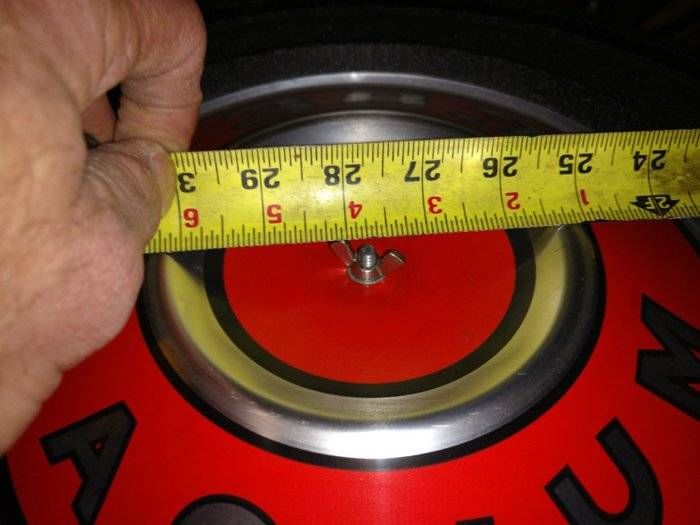

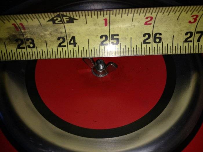

Dec 20, 2018 #4 DetMatt1 Well-Known Member Joined May 13, 2009 Messages 7,854 Reaction score 2,068 Location Metro Detroit Top pic is from passenger fender bottom is from driver’s side and I measure 41” from carb stud to tip of hood as it was almost closed.
