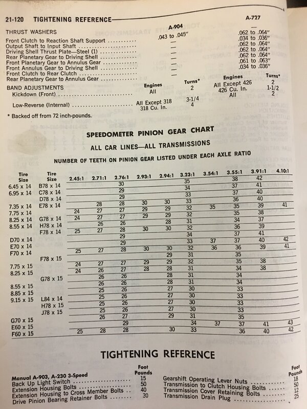

I recently reinstalled the gauge cluster in a 72 Challenger 340 auto with rally gauges. I didn't know if the speedo worked before since the needle had been broken off but is now replaced. Took the car out last night and the needle jumps wildly. A search of the forums finds no thread on this, googleing points to cleaning and lubing the cable.
What are your expert opinions? if it is clean and or lube, and helpful tips?
