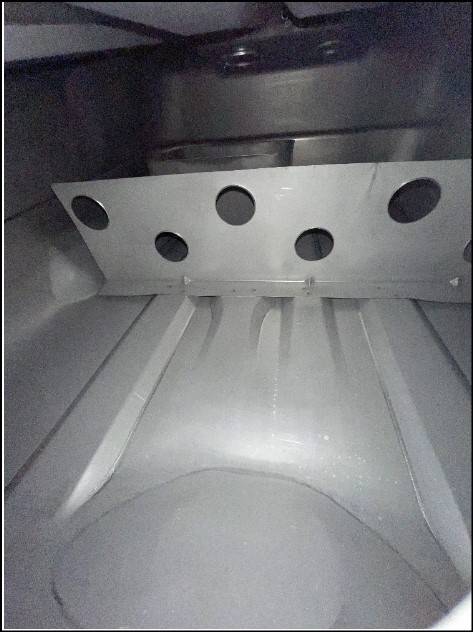

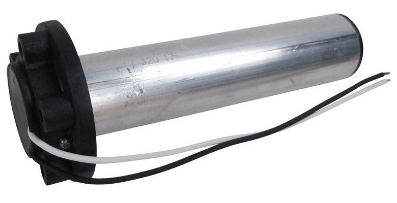

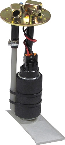

I second the Tanks, Inc tanks, sending units, and pumps. I have their tank with sump and baffle, their Walbro 255lph pump, and the floatless fuel gauge sending unit. Supports my Holley Terminator X Stealth EFI kit on a 440 stroker.
***That Holley pickup sock is theirs, not Tanks, Inc. and the sock is crazy cool on how it works.

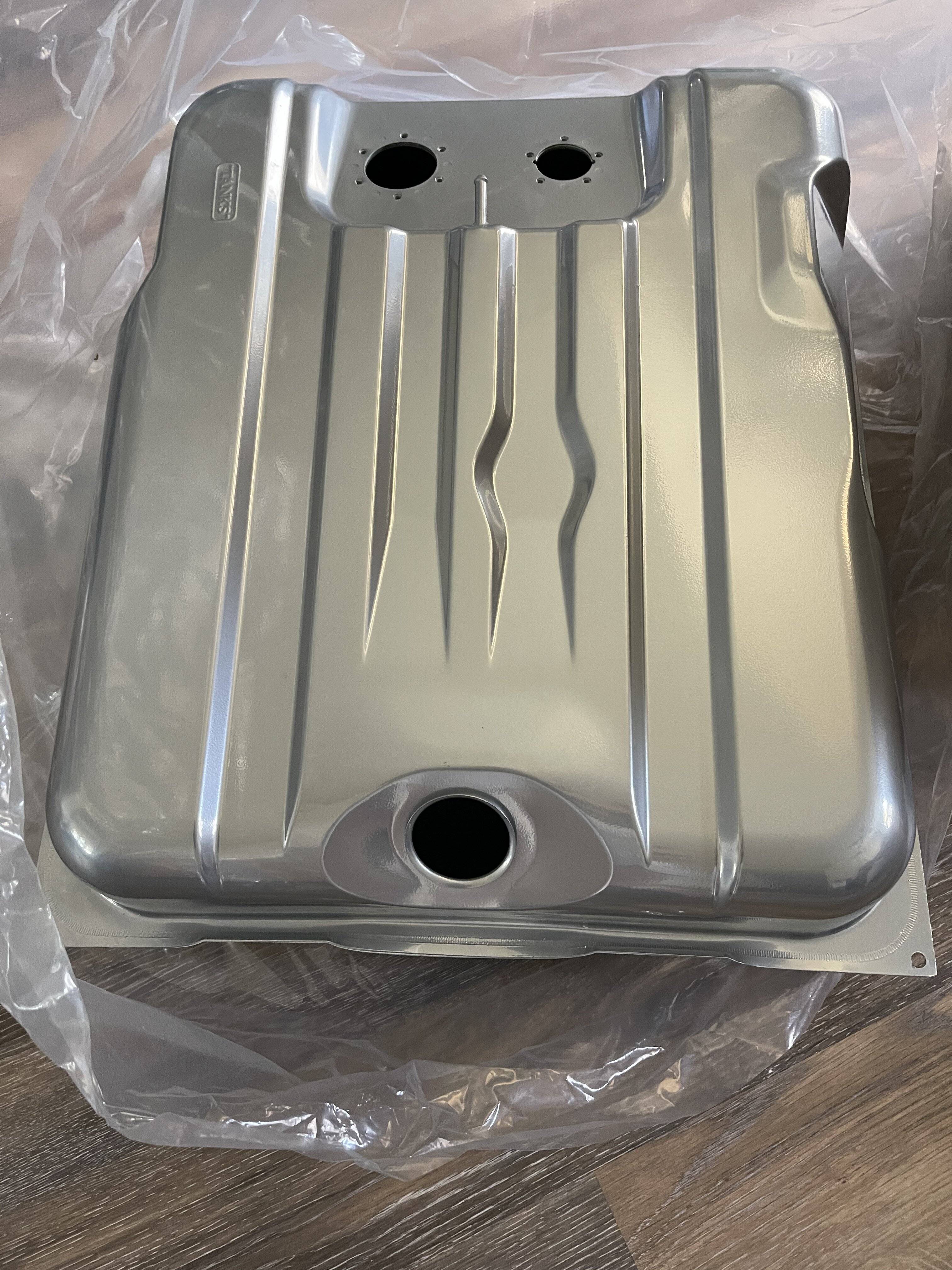

I've got the Tanks Inc and Walbro in my 48 Plymouth, with Sniper on my 360 Magnum. I like Tanks stuff. They didn't have the floatless sender then. I didn't set the float right. When it says 1/2 tank, get gas or push. Oddly enough, when I put new gauges and sender in, with the original tank, before EFI, it read spot on.
I've got a brand new tank for my Challenger, 74 with 383. Been thinking of getting a Tanks Inc with Walbro and putting EFI on it.
