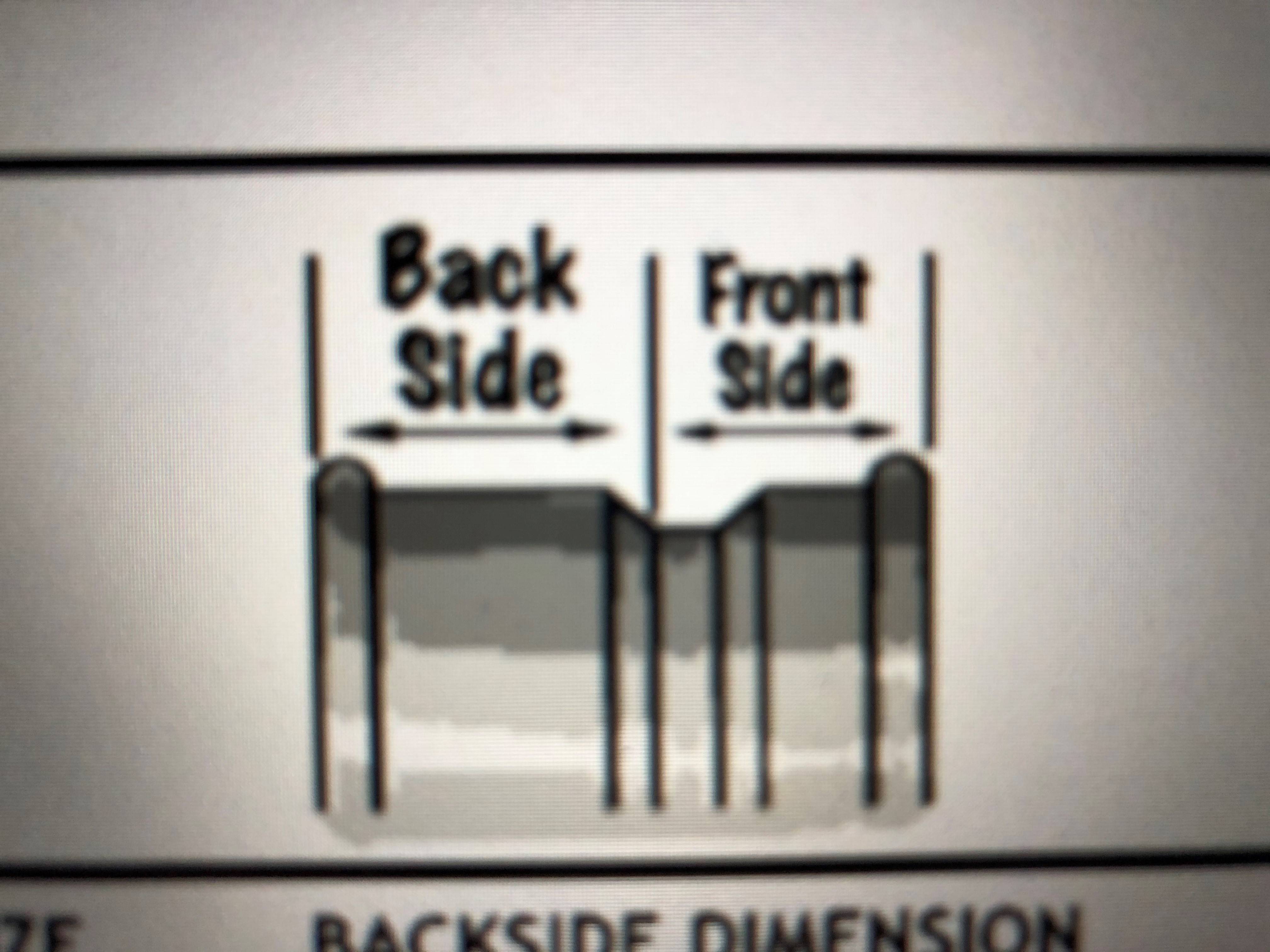

I am trying to order custom Factory Rally wheels for my 70 Cuda and need to know the correct trim rim that I can still order, and what is the dimension from the hub mounting area (back side) to the front of the wheel is to get the correct wheel and trim ring. Instead of back spacing it is the front spacing I am looking for.

I understand the 6 1/2" and 7" the reason I need to know the measurement from the face of the wheel to the wheel mounting surface is to get the exact measurement then I will order the backspacing to match the wheel width. and in the end will have the proper looking wheel finish.

The car is running a 11" wheel in the back now with a 7 3/8" backspace, so that will not be an issue. If I run a 10" with a 7 3/8" backspace that makes the front 3 5/8 from face to wheel mounting surface. If a stock wheel from face to mounting surface is 3 3/4" with a 4 1/4" backspace that is all I need to know.
I hope that make sense.

Here is a drawing with the measurements I'm looking for on a stock 15" Rally wheel. If someone has the trim ring depth for the same wheel I would appreciate it as well.
Thank you for the help.
