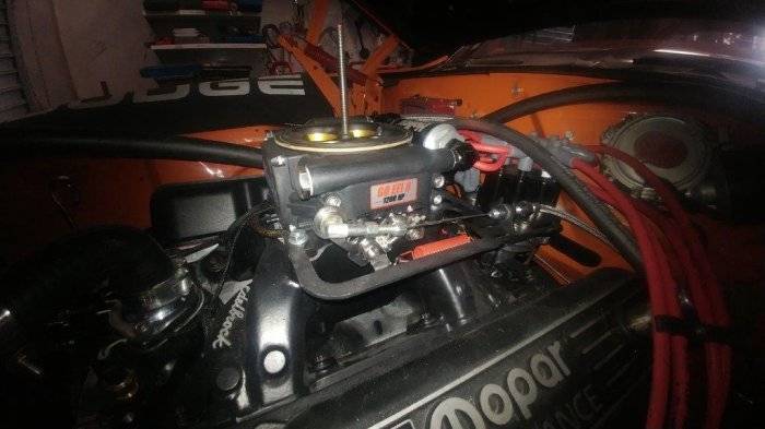

A lot better than the ezi efi crap was continually re-tuning the battery voltage on the display was about .8 volts out not good if your running the display.
When battery is reconnected the FAST resets the fan temp to about 185 where the Fitech when disconnected resets to 170
The Fitech is much cleaner through the whole range.
Used a Holley cable mount & shortened Lokar cable had to bent the throttle arm out slightly as it is just too close too the body.
Dont know why the aircleaner centre bolt has been changed from the old 1/4" to 5/16" so you must drill your air cleaner
Used a Holley 1200 on the rear rail very quite.
Used a Holley 1200 on the rear rail very quite.View attachment 35161
