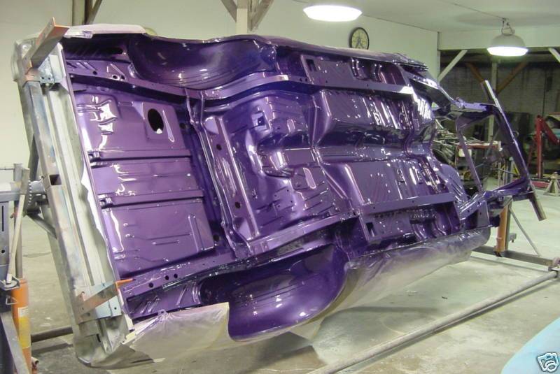

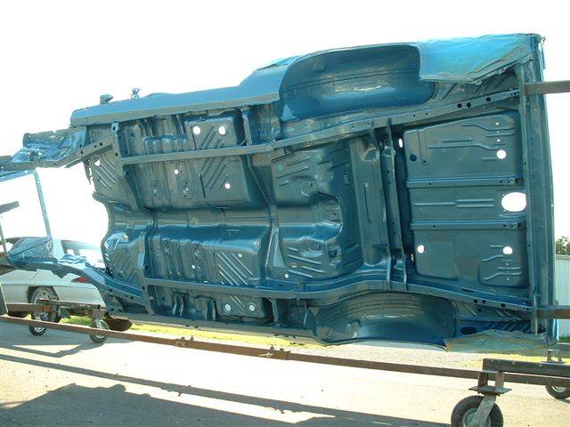

Can anyone help me with the measurements and or location where the brackets get welded
to. I had a less than desirable body shop remove and weld in a new trunk floor removing the old brackets. They don't remember where they went, and took no photos (as they said they would be). Live and learn as usual. Can someone help?

I have saved chassis pictures I have found in case I needed references as I need to also replace my trunk floor.
Does this help?
Not exact measurements but a good picture of location in relation to the under chassis.

In case you still need measurement's. These are off of my 1971 when I removed the trunk floor.
Base line. Support bracket tab's.
13.25 inches from frame rail to edge of outboard bracket tab.
6 inch's separate the inboard support bracket's.
