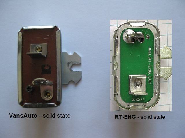

Just a tip if your gauges are acting up. I reconnected the temp gauge on a rally dash and it would
intermittently swing all the way up and down. Explains why there was an gauge installed under the dash.
Since I had the radio out to re-wire the alt. past the bulkhead I threw one of the RT engineering solid state
limiters and it straightened everything out. I don't have the oil pressure I had either but at least it's
accurate now...
