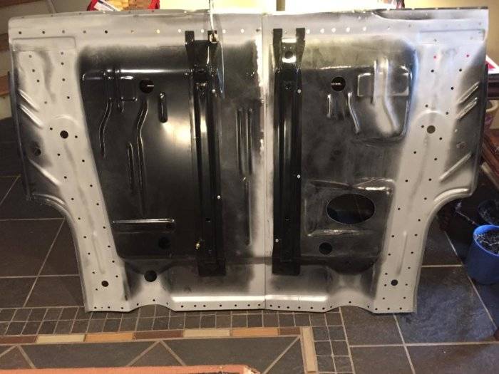

Has anyone used a portable spot welder to do certain welds like the tank braces to the bottom trunk panel. Since I have the two piece floor, the spot welder could be used to do the braces without drilling holes. Reviews give this unit a good rating granted you make sure all the paint is off the area where the panel/brace would meet.
Any thoughts on this? This unit is 120 v and sells for $170 with a 4 1/2 * Star rating.

I was getting ready to drill holes for plug welds in the gas tank brackets.
Was thinking it might be easier to spot weld with a new unit.

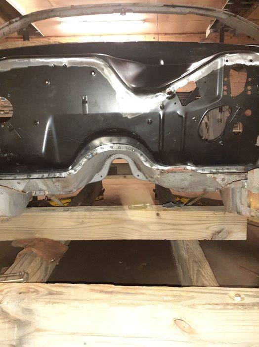

I've never used a short armer like that, I've heard they work fine but a pita to line up the tips and keep aligned. I would suggest that before you buy one, check the local marketplace (craigslist, fb, etc) for a used Lenco unit. I have one, paid only 350 for it with both the squeeze and wire tong set, and I love it. You can reach anywhere up to 5 feet or do both spots from the same side. You can get one cheaper, and resell it when you're done.

I've never used a short armer like that, I've heard they work fine but a pita to line up the tips and keep aligned. I would suggest that before you buy one, check the local marketplace (craigslist, fb, etc) for a used Lenco unit. I have one, paid only 350 for it with both the squeeze and wire tong set, and I love it. You can reach anywhere up to 5 feet or do both spots from the same side. You can get one cheaper, and resell it when you're done. View attachment 67023

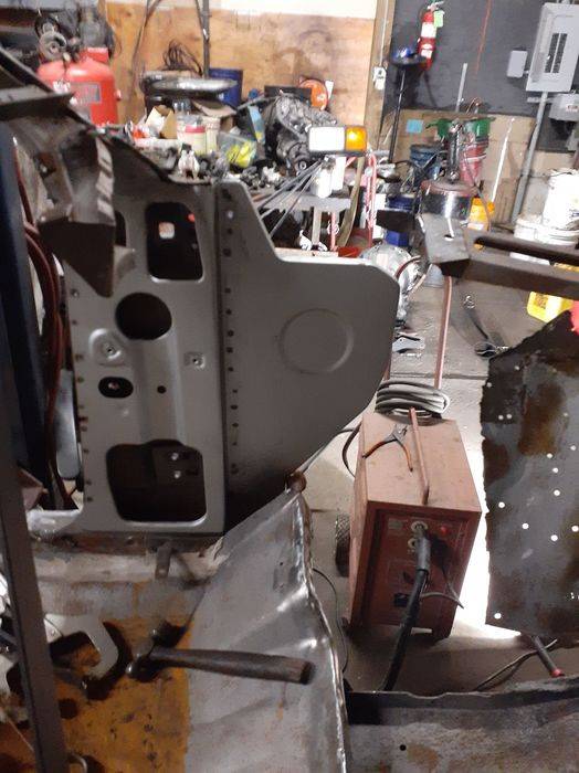

I forgot to post the pic of the welder, this is the only one I have with the welder in shot. It weighs about a hundred pounds, but doesn't take up a ton of space and has cables about six feet long with a pretty good timer, coarse and fine adjustments. It's a transformer machine so it will last forever; mine was sold in 84 and works like new. Parts are still made for it. Power is 240V single phase, and the power cord is about 50 feet long.

BTW, how much of a PITA was it to change this firewall?
It was really easy, because I was already committed to changing the rails. I used a goodmark firewall and cowl, and it fit like a glove. I kept the old inner fenders and rails on for a reference point, and matched it right up. The floors had already been done years ago, and they cut them and laid them over the seams, so I had to remake the flanges. I don't know, therefore, if they would be so easy and fit so well on an original floor flange. The great fit encouraged me to buy goodmark rails, and they were considerably different from the original, but I had taken enough measurements to figure it out before welding it all up. The new rails are narrower near the torque struts, and the height of the rail top is about a half inch less than the factory units, but the lower holes (the important ones) fit right in like a glove.
