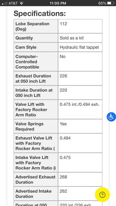

This Lunati can might be an option to consider?? I’d go a little bigger though
Chryco Psycho
4,402
2,042
Panama
with a low compression engine I would go 1 smaller keeping the duration @ 50 in the 218 range
