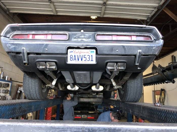

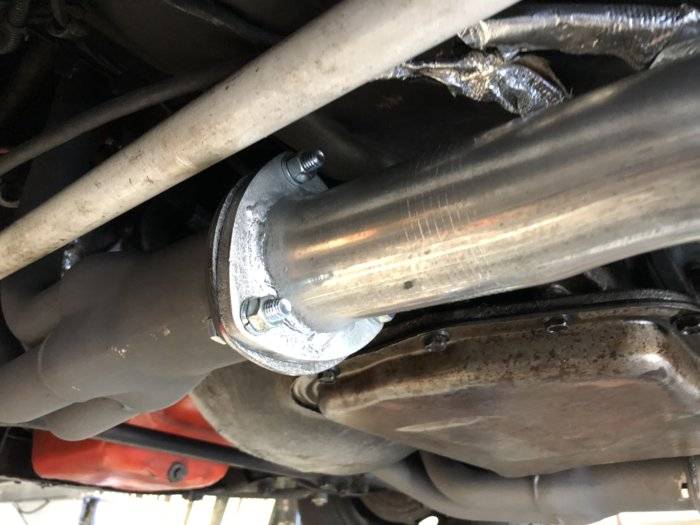

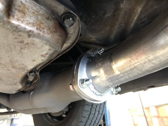

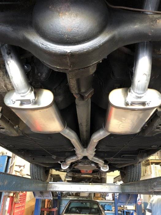

I had my buddy install the headers at his shop today. He had to remove the starter to get the driver side header in then install the starter again. It’s tight but he didn’t have to disconnect the motor mount(s). Two tubes just touch the steering box, one just touches the heat shield on the small starter Solenoid, one touches the torsion bar. None of the tubes had to be dented to finish the install. I drove it 15 miles (slowly) with open headers to the shop where the exhaust will be built and installed Tuesday. It will be 2.5 inch with X crossover, 14 inch Magnaflow turbo mufflers, no resonators, and stainless “Challenger style” quad tips in the valence cutouts.

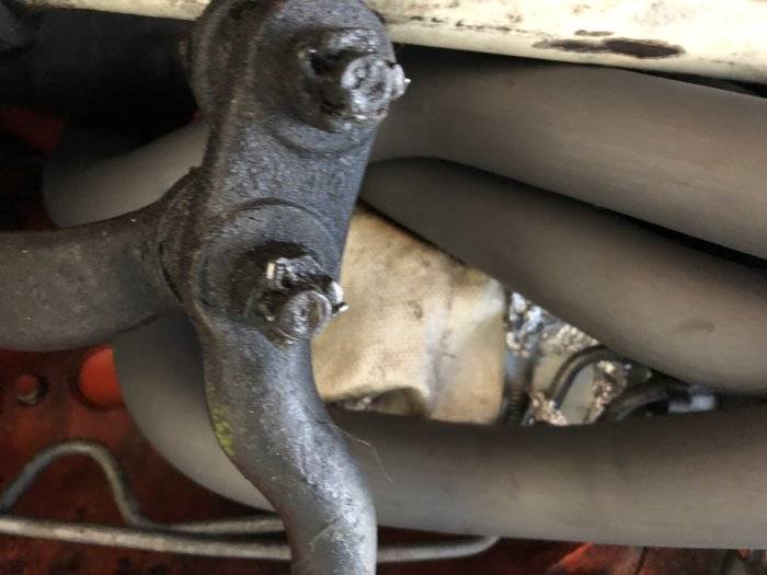

OK so the headers are in. The mini starter is in. Two pipes touch the power steering box. One pipe touches the heat blanket I wrapped around the starter. And one pipe touches the torsion bar. The clearance under the car is great compared to what I thought it would be. I had the custom exhaust built yesterday. Even though I switched from Factory manifolds and 2 1/4 inch pipes, it is quieter now that I have headers and 2 1/2 inch pipes with 14 inch magnaflow turbo 11225 mufflers. I am really surprised that it is quieter after the new install.
