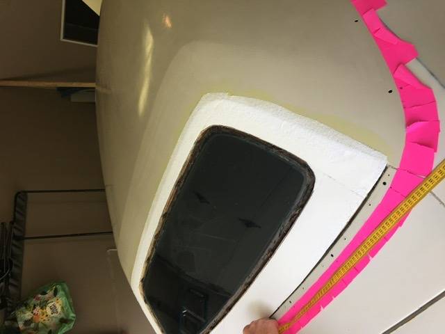

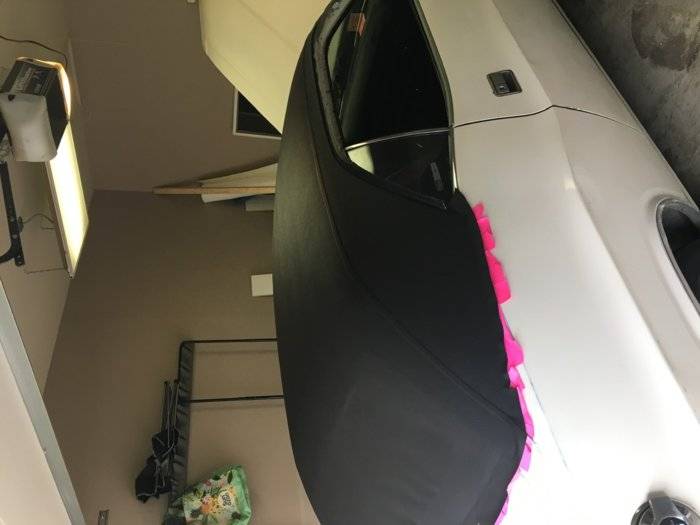

    I just did my vinyl top last year. I bought sandable foam off ebay. I glued it not just to the window plug but also on the roof and the sanded it flush. That is the way it was when I pulled the old vinyl. It really looks good and leaves no noticeable gap roof to window plug.

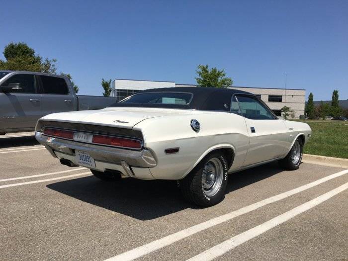

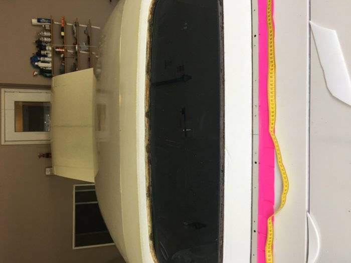

  4. Glas86
    Glas86 Member
    Messages:
    16
    Likes Received:
    18
    Joined:
    Mar 30, 2018

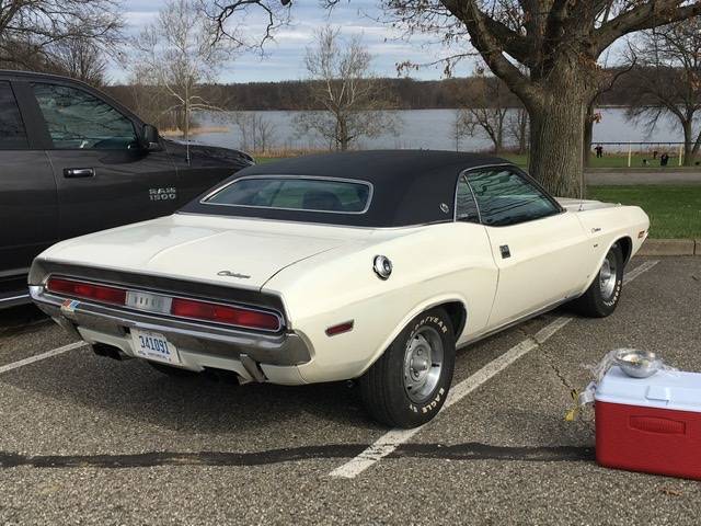

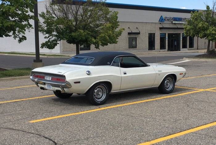

    Photos
    • Like Like x 2

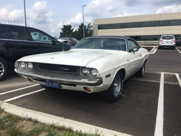

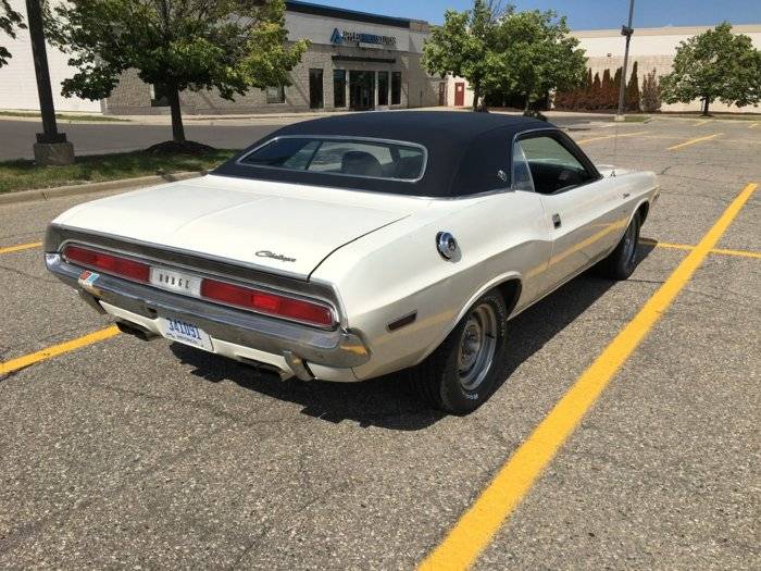

    Is yours a white SE as well? Do you have the rallye hood? Would be great to see how that looks. Still debating with myself if I change that. Its so hard to find good pictures of a white 70 with vinyl. I do have a flat one right now. Here are some more Pictures of my car top.
    • Like Like x 4

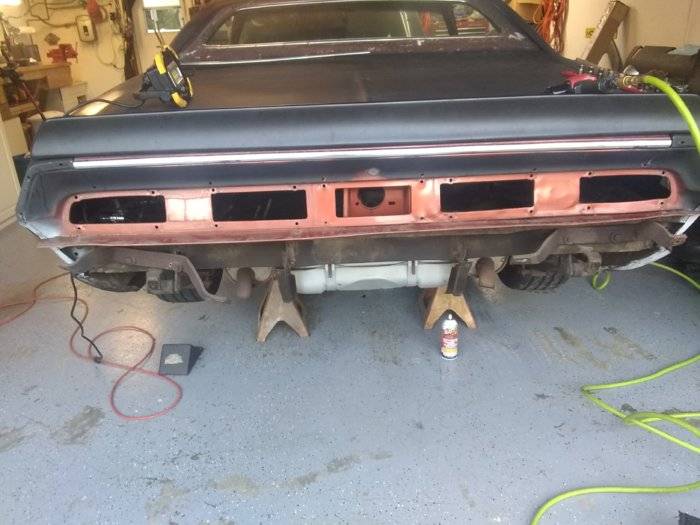

    Pic
