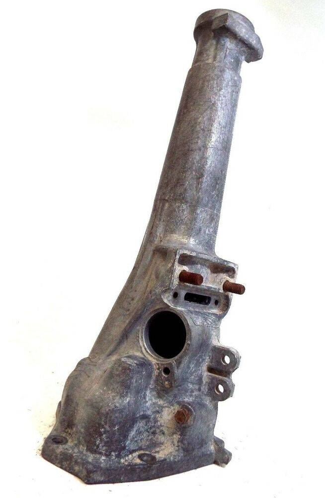

As far as case considerations go, the only thing you absolutely need to have is the mounting boss for the lower shift-rod bracket. The boss is visible in the photo below, the tab with two holes to the right of the speedometer gear opening. Not all 727s have it, and without it you're dead in the water installing a factory floor shifter.
