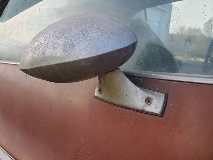

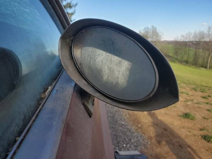

Apr 28, 2020 #1 fk5dave Member Joined Dec 28, 2015 Messages 20 Reaction score 0 Location Pittsburgh, PA hi guys. can anybody help me identify if this is a stock RH mirror on 70 challenger? or an aftermarket/incorrect add on. thanks
Apr 29, 2020 #2 floyd Well-Known Member Joined Mar 18, 2012 Messages 275 Reaction score 151 Stock/OEM
Apr 29, 2020 #3 sixpactogo Well-Known Member Joined Mar 4, 2017 Messages 313 Reaction score 84 Location Eau Claire, Wisconsin Looks like a stock mirror to me but something is amiss. Is it bent somehow? It shouldn't be tipped down like it is.
Apr 29, 2020 #4 Old B5 Well-Known Member Joined Dec 19, 2017 Messages 82 Reaction score 13 Location Evansville, IN I agree with the previous post. It’s the correct mirror but something is not right with it. It might be mounted in the wrong location.
Apr 29, 2020 #5 challenger6pak Well-Known Member Joined Feb 27, 2011 Messages 4,037 Reaction score 897 It may be an Abody version of the mirror.
Apr 29, 2020 #6 C Chryco Psycho Well-Known Member Joined Dec 28, 2008 Messages 4,452 Reaction score 2,095 Location Panama I agree either the base is damaged or it is an A body base
May 14, 2020 #7 1971 Gran Coupe Well-Known Member Joined Feb 9, 2016 Messages 46 Reaction score 19 Here is an NOS 70 mirror. I am going say it is not attached to the base corretly from the pictures. That is not an A Body mount.
