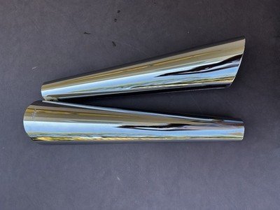

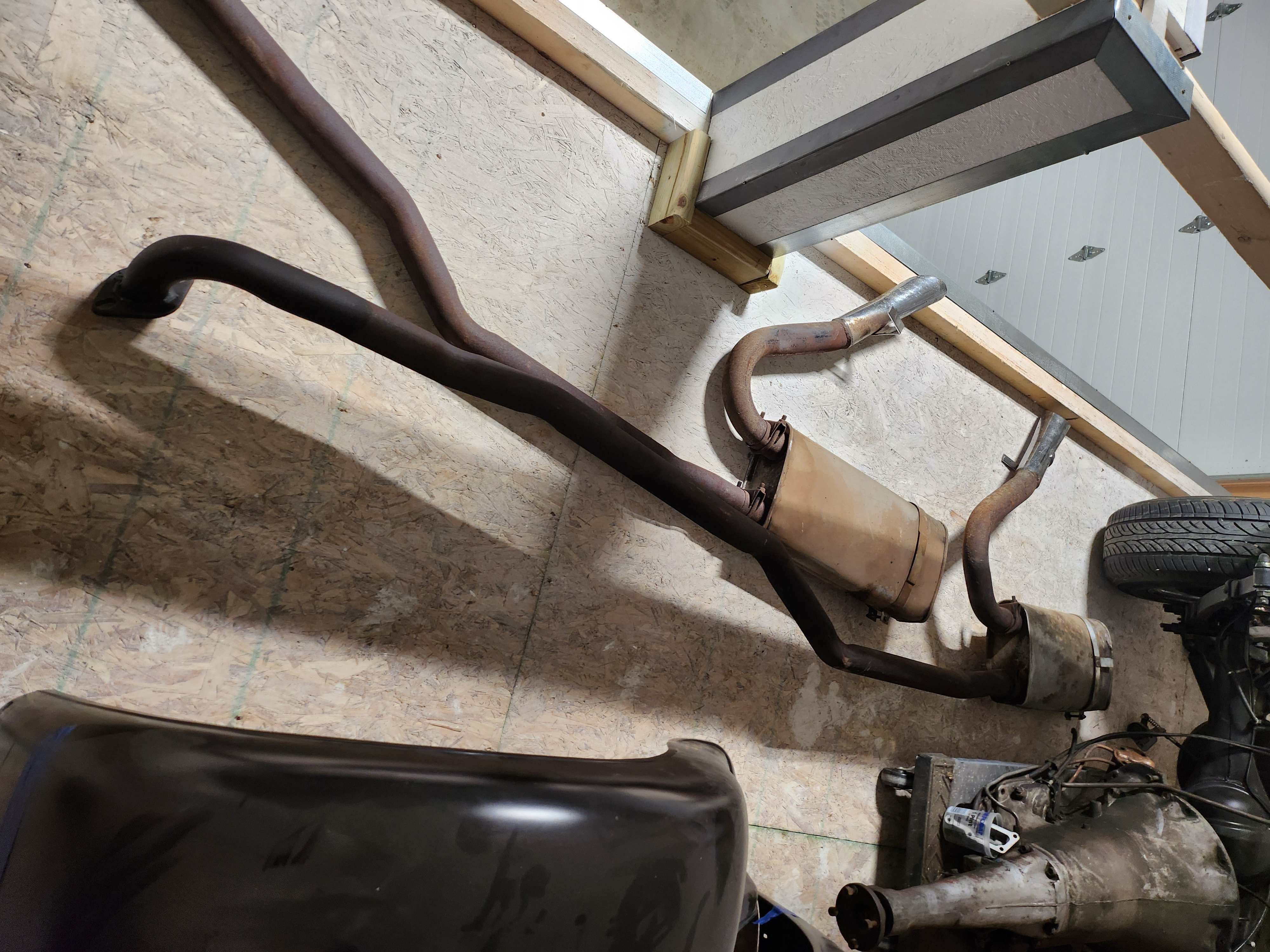

Building a 416 stroker for my 70 AAR. Wanting to keep the look of the original chrome tips, but with headers 3' head pipes to 3' power stick mufflers (skipping the u turn mufflers} into the chrome Trumpet tips. The baffle has to go for sure inside, but after looking beyond that looks like about a 2" hole for the exhaust flow. I saw some chinesium high flow from a company but now there not available. I was wondering if anyone has sourced or fabbed new ones for a better flow Thanks in advance.

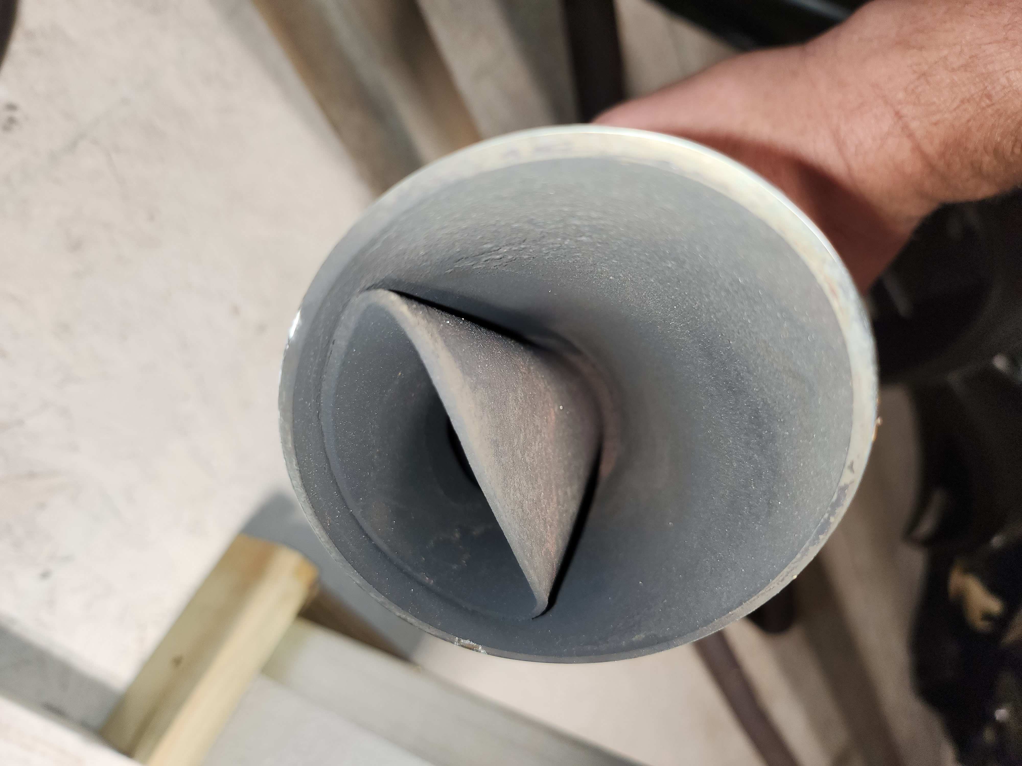

Went and measured the original ones diameter. I knew it would be quite invasive, 😁 , but I can cut it off and weld the 2 1/2" exhaust to the 4 or 5" piece left of the conical trumpet end. reweld the hanger and have it chromed for the original look or paint it black. thinking chrome.
Just slip your stock tip into the larger exhaust pipe you want to use, Mark the tip where it snugs up inside the new pipe and cut it off where needed and remove the baffles.
Yes thats what i was thinking but it will be past the baffles closer towards the end of trumpet flare to catch the 2 1/2" that I will be using. I was looking beyond the baffles and I was thinking it is around a 2" diameter at that point and it looks like the factory flattened the bottom of it for look or ground clearance.
