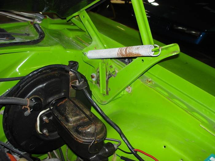

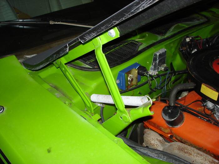

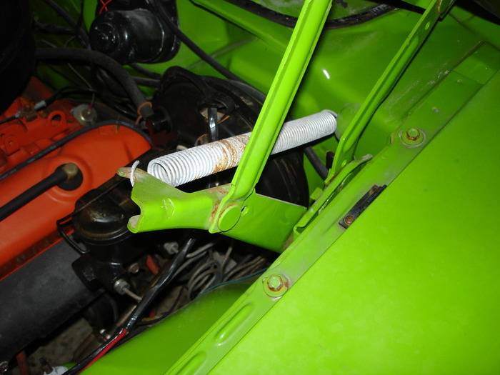

The pics
Shut
Jan 20, 2016
94
FL
I support the hood with a stick (to take the pics)

Judging from your pictures, the springs look to be light duty! with out being there, I would think it's your hing springs that are weak and won't hold your hood open.
challenger6pak
Feb 27, 2011
4,087
923
The hinges are weak because the hood is weak. If you put stronger springs on the hinge, the hood will warp and most likely break just after where the hinge makes contact with the hood. Choices are to prop up the hood, as mentioned, or replace the hood with a steel hood and add stronger springs to the hinges.
