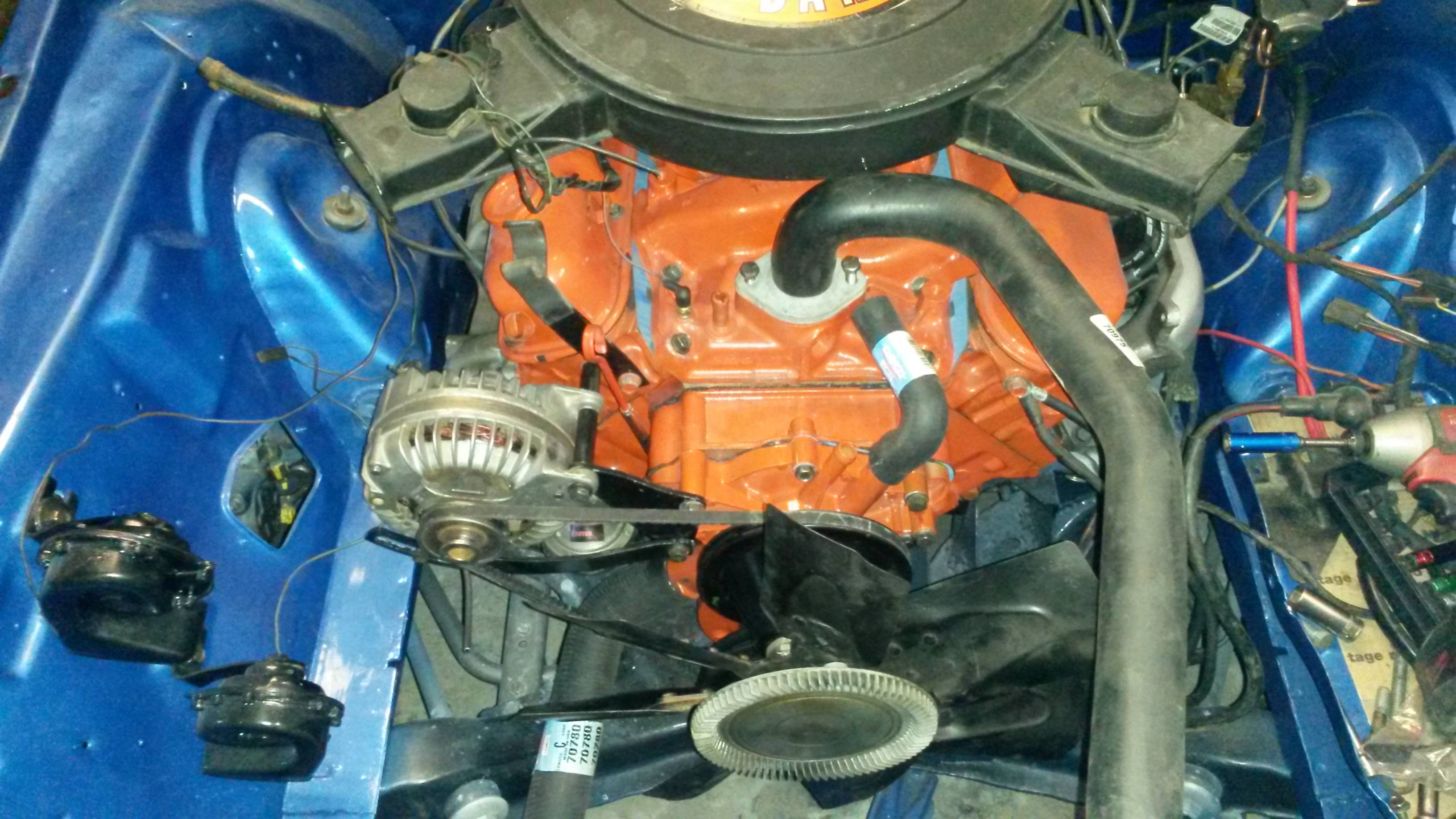

Anyone got a photo of the orientation of the horns on a 73 Chally? I'm thinking they need to have the horn output oriented down so water never collects in them, but my wires are too short in that configuration.
Down is correct for all horns. Be sure the washers bits into bracket to complete the circuit.Anyone got a photo of the orientation of the horns on a 73 Chally? I'm thinking they need to have the horn output oriented down so water never collects in them, but my wires are too short in that configuration.
